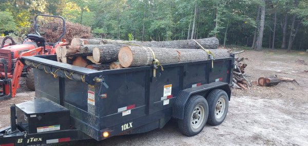

    Your truck will pull that dump trailer. Just can't put heavy loads at the front.
    Definitely buy a brake controller.

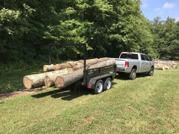

    Net wt load on our trailer is about 6600#, legally. This was a bit more. 0531221938a.jpg

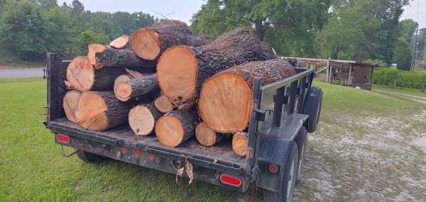

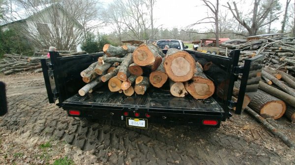

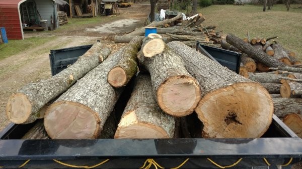

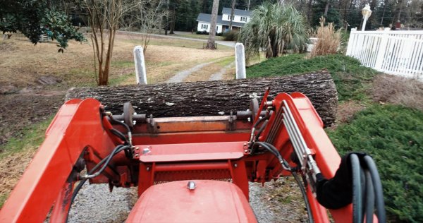

    Forks work great for loading logs, just be careful not to drop them hard on the trailer. IMG_20190216_181812.jpg

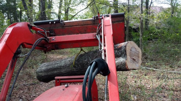

    Our bucket has 2 hooks welded on top. Short chain and tongs worked well before we got forks or grapple... IMG_20181025_113056369.jpg

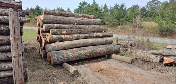

    It would be best to just dump on the ground and then stack on poles later.

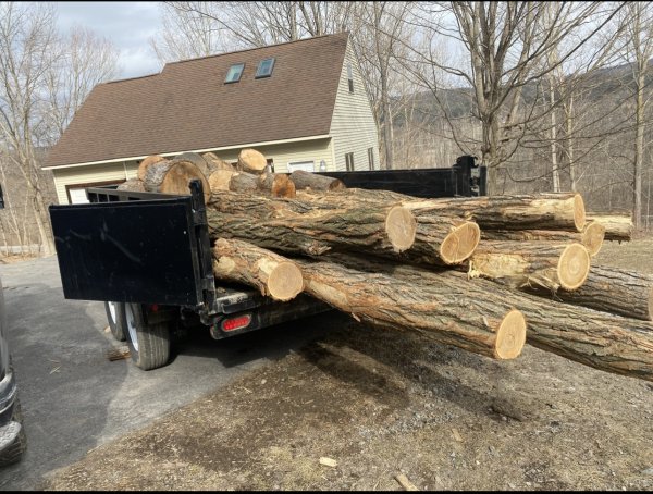

    B3F412A0-8910-441B-BD98-54F3A1CC4357.jpeg Kinda my not how to load a trailer picture. I only went two miles but pulled with my tractor. If you are going to buck on the trailer, I would simply buck at the log pile and load into your truck. Avoid the cost and added steps. You can also hook a chain to a tree and carefully pull them off, roll to side and repeat, just be careful with damage to the trailer.
