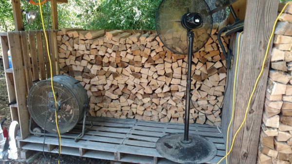

    Been my experience water logged wood will dry pretty quick once removed from the wetness. Still warm enough in your area to dry it on the quick side. Air movement is one of the three things needed for drying wood besides sun exposure and time.
    Ive contemplated a fan to dry my bundle wood stacks faster. Even getting some type of solar generator set up for power as its a distance from a power source.
    Im interested to hear Jeff's input as I thought the fans were for them when they worked in the heat.
