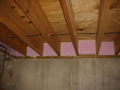

    Insulate around the outer wall only (IMO)... the sill plate area. Get a couple sheets of 3/4 or 1" rigid foam insulation board, cut loose fitting panels to go above the sill plate, between the joists. Then seal the gap around the foam panels with some expanding spray foam. Also seal where the sill plate meets the concrete or block wall with spray foam. This will seal up any air intrusion and help insulate a lot. It takes a little time, but not too bad, and the return on your investment is good...to me this is an obvious "low hanging fruit" type of DIY insulation/air seal project...knock it out first...then see what needs attention from there.

    You could use 2" thick if you want...the R value it has, coupled with the air sealing (that's the big thing right there) will be a huge improvement over what is likely there now (probably nothing) (its not uncommon to be able to see light between the sill plate/basement wall, that's why I said the air sealing part makes such a huge difference)

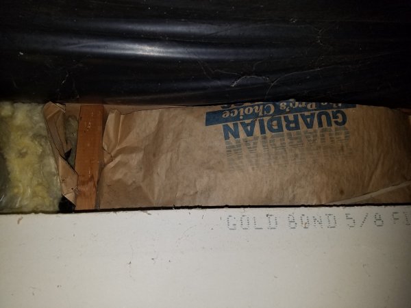

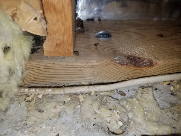

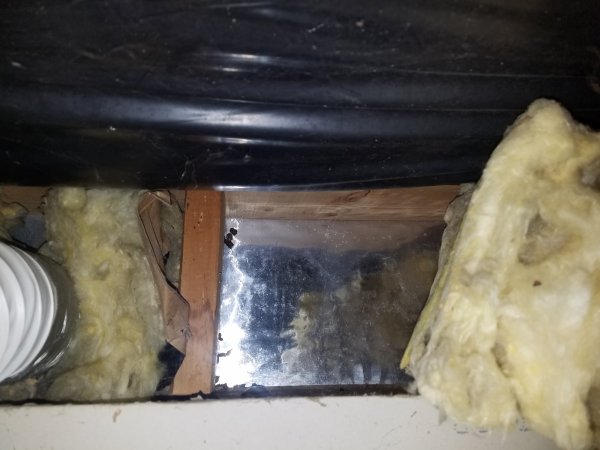

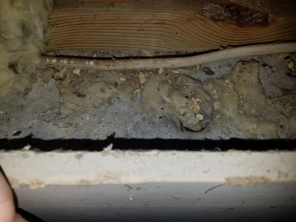

    Finally got a chance to check the rim joists in the basement. It looks as though they have rigid insulation installed with fiberglass insulation behind them. I definitely need to use some canned spray foam around the edges. I could feel cold air coming in. I'm gonna spray foam where they sit on the foundation walls as well as brenndatomu suggested. The main culprit of cold air seems to be coming in above the ceiling from the garage though. For now I'm gonna stuff some rock wool up there and come up with a more permanent solution this summer. The rim joist insulation reinforcement will happen this summer too. No wonder we have always had a spider problem in the winter months :picard:

    Cutting the rigid foam smaller than the cavity so there would be room for expanding foam on all 4 sides. There were places you could see outside and mice and / or chipmunks were coming in before I wind sealed with the rigid foam. I found stashes of acorns on some of the sills. I used the foil coated rigid foam though . Regular glass insulation beside the foam. HUGE difference in the temp of the basement .
