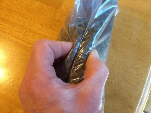

    Englanders parts are pricey, you can get baffle material elsewhere and cut it yourself though, I tried door gasket from the local stove shop once, was not as good as the "high density" stuff you get from englander...here's a pic englander gasket on the right.
