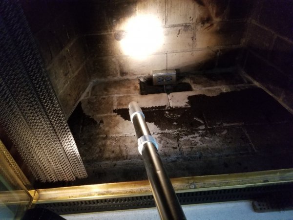

    First the cleanup of the firebox and I mounted and electrical box in the back of the FB. I checked with SBI and they indicated I could indeed tuck the cord back behind the insert and plug it in. I had heard that by code you need to be able to unplug the blower in an emergency. Right or wrong I opted to hide the cable vs. having it strung across my family into a nearby outlet.

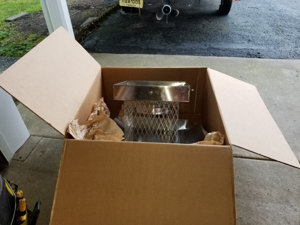

    The goods have arrived! I went with a 6" SS Pre-insulated liner and a new top cap with a
    nifty flip top for easy cleaning.

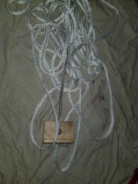

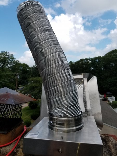

    Made a homemade pull system by attaching a 2x4 inside the mouth of the liner and screwing it in place. Attached a rope through the center of the 2x4.
    It worked just fine with no problems. Wife and I were able to pull the liner with little trouble down the chimney.

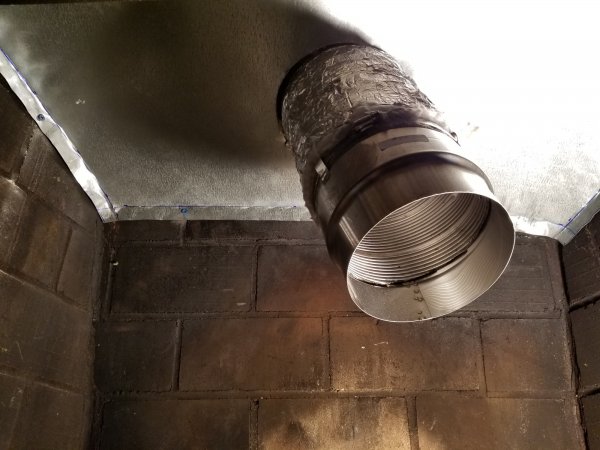

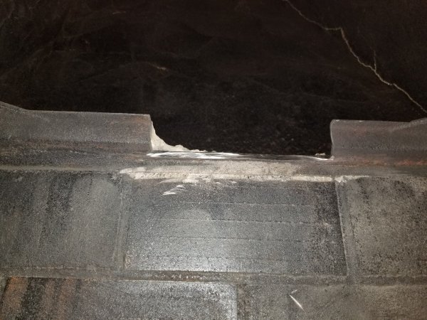

    Removed damper lid and had to grid out part of the damper to pass the liner through. I was able to grind out enough to pass the entire liner through with outer shell and insulation. However I opted to strip the outer shell and insulation to give me more flex with the liner.
    Next was the block off plate. I had stuffed Roxel up into the throat as much as possible nice and tight. I made a block off plate and admittedly wasn't a great job but I think it will do the trick. Before putting the block plate into place I measured and cut a bat of roxul to match the size of the block off plate and cut a hole in the insulation to pass the liner through.

    Back on the roof to trim the excess liner and place the top cap!!!
    Final product with trim kit.....O and managed to hang out last name on the chimney as well!

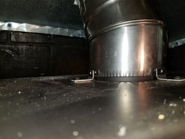

    Good for you guys tackling this DIY fashion. The only thing I'd add is that your appliance connector crimped end is supposed to slide into your stove collar. Any rain water/ liquid creo. etc. normally is directed back into the stove at that connection. Might consider fitting it down into the stove. Perhaps flip your mount tabs so the long leg is pointing up to fasten the connector. A leak at this joint can make a mess of your new toy:eek:. Rust. Goopy.
    Unless things have changed??

    That connector coller is in that stove a good inch and 1/4". You may see a little crimped part showing but its in there

    Perfect! I gotta get my eyes checked:whistle:

    BTW, at first I thought the appliance connector was backwards too...:binoculars:

    I measured the crimped part of the adapter and it was about 1" 1/2" of crimp. Roughly 1/4" showing so i feel pretty confident its in there plenty enough. Thanks fellas!!!!!
