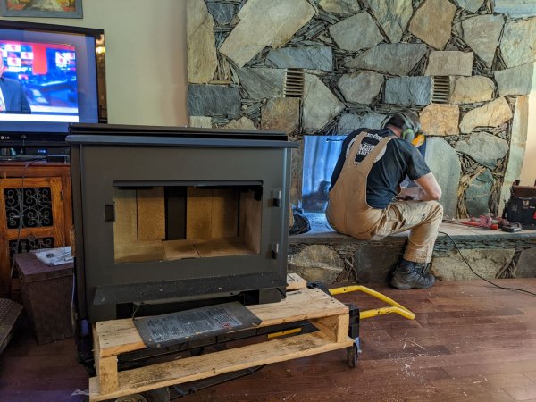

    The Drolet 1800i was installed this weekend
    Andrew did the installation and I assisted him, I learned a lot

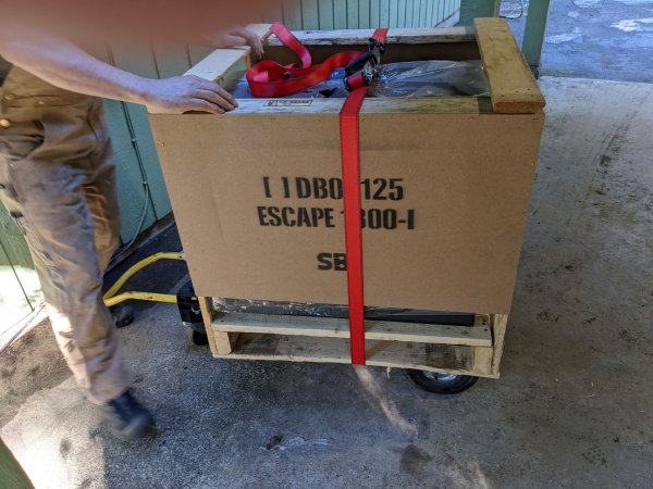

    It has been waiting patiently in the carport

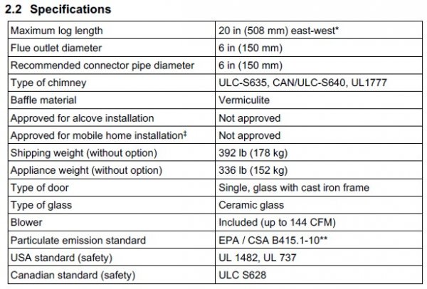

    It's quite heavy, 392lbs according to the website
    Getting it up the stairs into the house was hard, Andrew pulled and I pushed.
    All those years playing rugby finally payed off

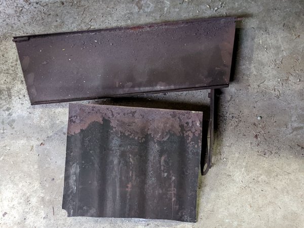

    Cutting the damper to make room for the liner

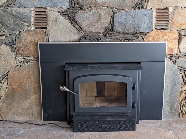

    It's in

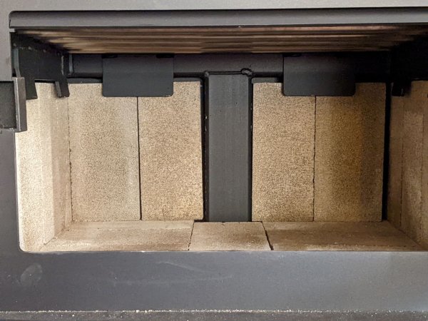

    New and clean inside

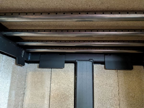

    The secondaries I've read about so much

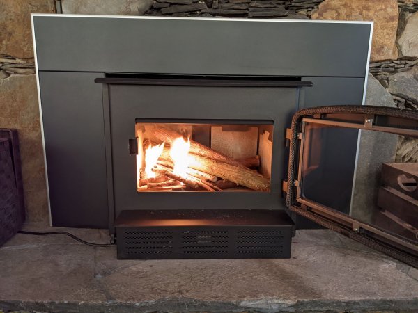

    Testing it, lighting the first small fire

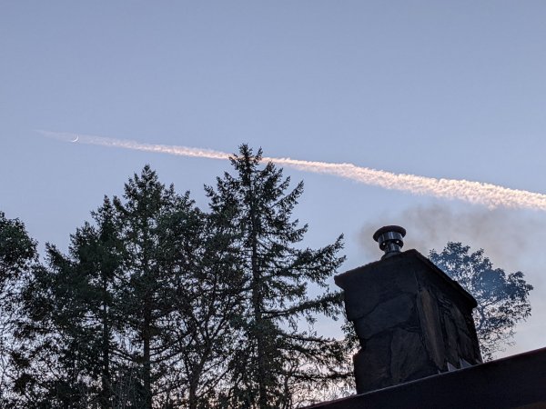

    Checking the chimney, very lucky having the smoke, a vapor trail and the moon in the pic
    It was worth it. It did smell of burning paint, but it wasn't too bad.
    The second fire didn't smell, I was able to get the living room up to 75F (24C) and the rest of the floor to 71f (22C)

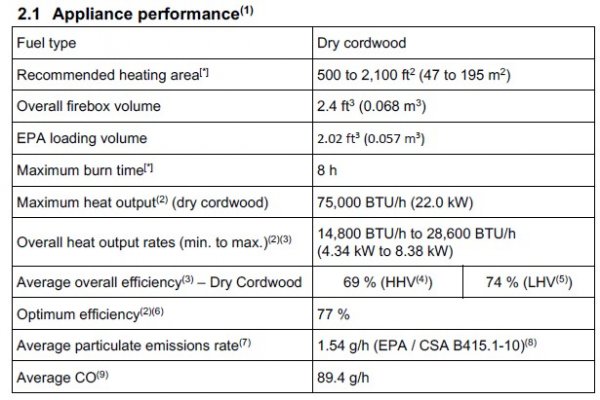

    What's the size of the fire box ?

    Is that the old damper plate that was removed?

    2.4 ft

    Yes, he had to cut it away to make room for the liner

    Looking at the pic of the damper that was cut out...that looks strange to me...was this a masonry fireplace or a prefab unit?

    It was a masonry fireplace with a steel liner
    He had to cut out the damper and a part of the angled "ledge" at the back
    A lot of dust on it came down with the "ledge"
  9. brenndatomu
    22,395
    142,241
    Good...because putting a stove into the shell of a prefab unit inside a stick built "fake" fireplace is something that your insurance company could use to get out of paying if something stove/chimney related ever happened.

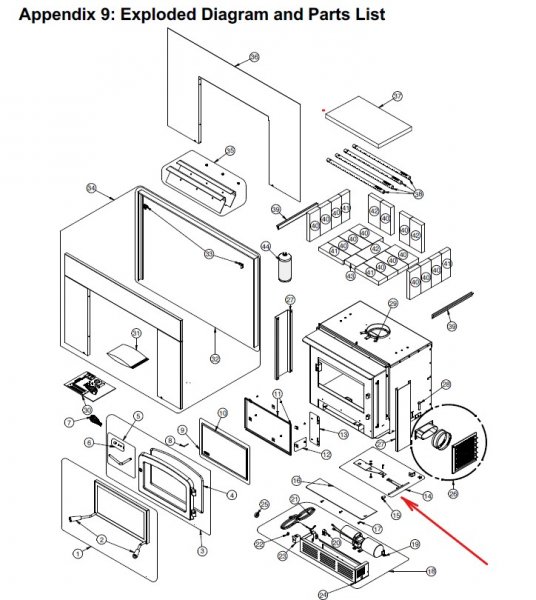

    I don't think you can shut air down completely, when we installed it I saw there was about a 3/8" hole in air control plate
    It might be because it's EPA 2020 compliant

  17. Buck
    Buck
    Nov 4, 2021
    19
    83
    Victoria, BC
    100% Correct, I thinh you would have to disconnect the liner, pull the insert out and put it on its side to get at it

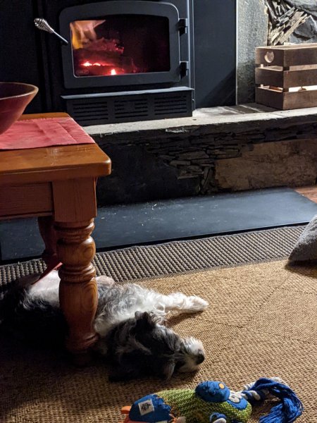

    I'm still learning how to use it but I'm enjoying it a lot
    Our dogs love it too
    yooperdave, Ohio, blacktail and 3 others like this.
