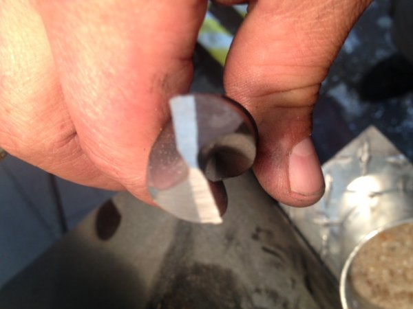

    I have not had any luck with those, but I learned to hand sharpen, and it's definitely a skill worth learning.

    Ok, I said screw it and ran 75-100 bits through it. And then... started punching holes in some 1-1/2" Cold rolled round. I had 4 pieces @ 4" I had to open up to 5/8"+ ID. #2 center drill for a pilot, then 5 stepped sizes until I hit .625. I was not gentle nor was I slow. I did not have the lathe in back-gear, I went Med. high and slower on the feed. And they cut fine. Not smooth, but they made a hole. I used a straight flute reamer to clean up the holes, but it really didn't do anything. All-n-all, for rough boring, it worked fine for sharpening. JB
    Oh yeah, I never had to sharpen any bit I used during this process, so 16" of CRR and they're still Ok.
