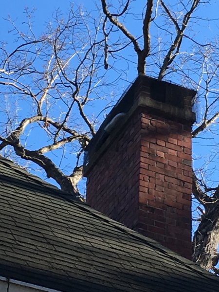

  11. Kevin1024
    Kevin1024
    Nov 27, 2016
    55
    184
    Nj
    The OAK is 3 inch pipe and the guy who installed it said he put the pipes on opposite sides of the chimney specifically for that reason. To disconnect the OAK, just pull out the pipe from the stove and that's it?

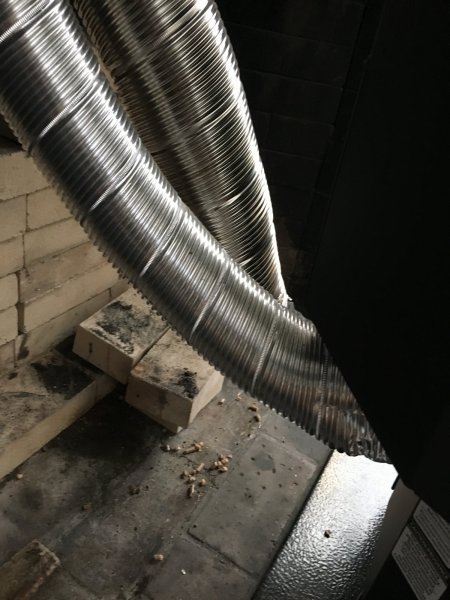

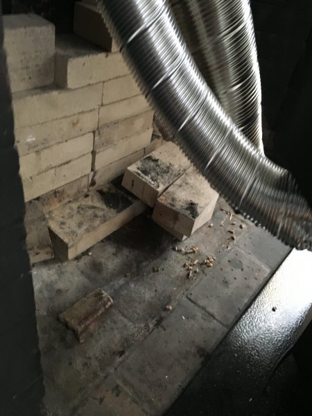

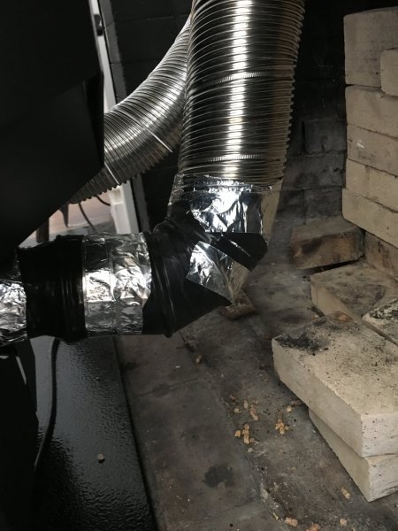

    Pics!! The first chimney pic you can vaguely see the OAK leaning sideways and the last one is the other side of the chimney where the chimney pipe is

    Added pics in the last post of my setup!

  14. SmokeyTheBear
    SmokeyTheBear
    8,186
    38,850
    Standish, ME
    No good yes

  15. slvrblkk
    slvrblkk
    6,647
    29,535
    Northampton, PA
    I hope that's black silicone tape on that vent.
    That probably should have a clean out T on that.

  16. SmokeyTheBear
    SmokeyTheBear
    8,186
    38,850
    Standish, ME
    OAK and exhaust should exit on the same side with the exhaust at least 2 feet above the OAK that horizontal portion is a no no both must be as free of bends as possible.

  17. SmokeyTheBear
    SmokeyTheBear
    8,186
    38,850
    Standish, ME
    Now with them on opposite sides (wind related) the vacuum switch in the stove can cause a loss of fire, or in the case of a Harman a 6 blink shutdown or other vacuum related problem.

  18. Kevin1024

  19. Kevin1024
    Kevin1024
    Nov 27, 2016
    55
    184
    Nj
    What's the down side of they are on opposite sides?
