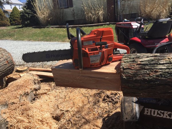

    I like the Husky/Oregon rsn 16’s. I have one for my 346 and one for my 394. :D
