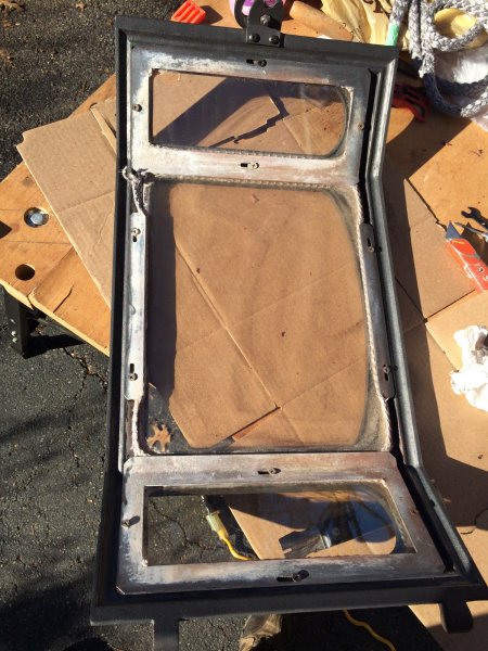

    I'm replacing my door gasket. The stove store sold me s tube of Rutland cement. Upon pulling the old gasket I find it was held in with silicon.
    So which is better?
    bert the turtle and wildwest like this.
  2. Paul bunion
    Paul bunion
    3,365
    13,193
    Got the old silicon out. 2 hours and 2 Dremel wire wheels later. It took me a while to figure out the Dremel trick. I was getting nowhere with a razor blade and nail polish remover.

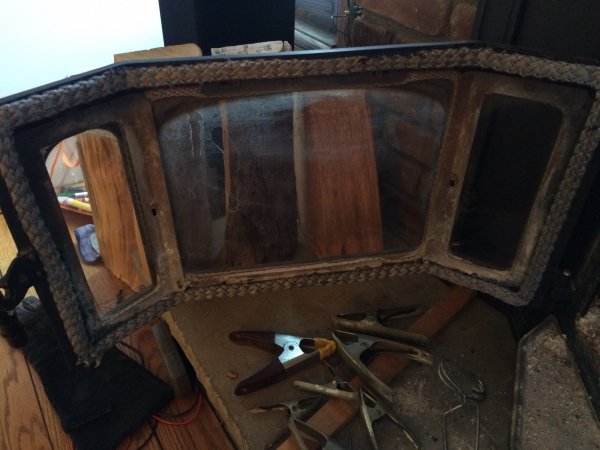

    Cement went on real easy. Waiting for it to dry for an hour then it will be curing fire. I'm glad that I have a pile of clamps for holding the corners and angles. It think it would have sucked getting the rope into place without them.
