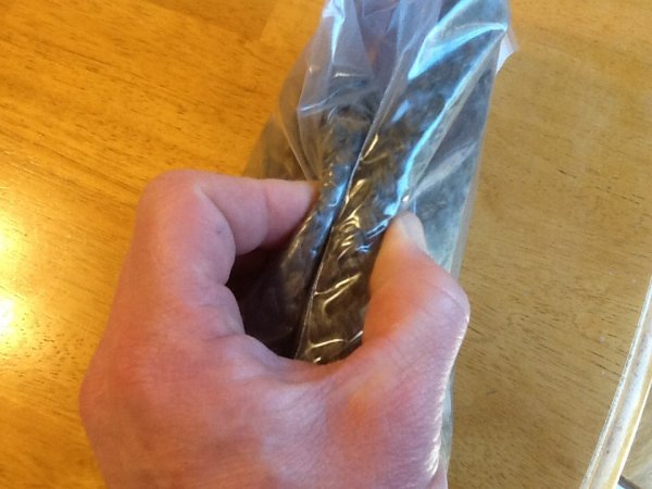

    Replaced my door and window gaskets today. Almost used the "standard" gasket the local stove shop sold me again. Someone around here said to use the stuff from Englander as it's gooder more dense stuff, so I ordered some up...sure enough. Here is a pic of the "standard" gasket (left) along side the stuff from Englander being squished between my fingers. And now my door latches a lot higher and has a much more positive feel.
    MightyWhitey and Well Seasoned like this.
  8. Well Seasoned
    83,785
    Wow, big difference. Good thinking on getting the better stuff!:yes:
