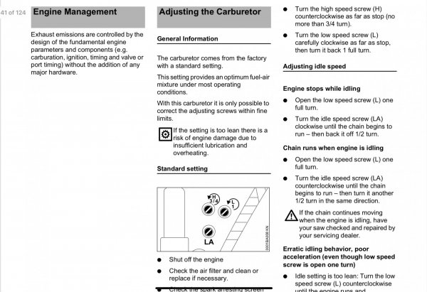

  20. stuckinthemuck
    stuckinthemuck
    3,218
    15,076
    While that is true of the pro saws that are currently offered because all “c” designated pro saws are also m designated saws, it is not true that ALL saws with the c designation are mtronic. Previously, there were pro saws that were “c” designated such as the MS362C-Q which was a comfort-quick stop saw but not mtronic and thus manually adjustable..
