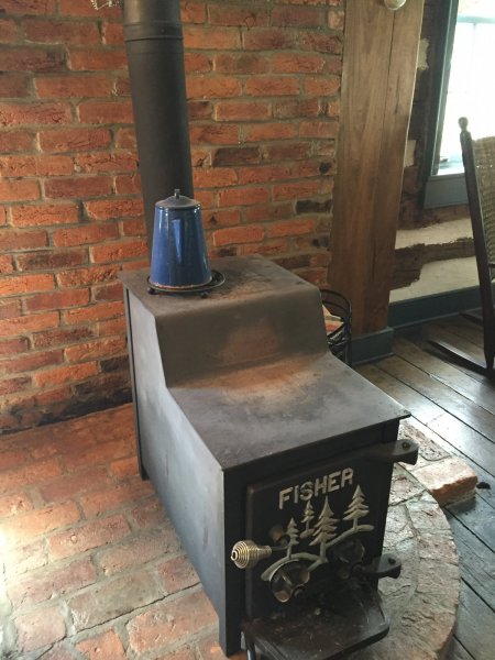

    I don't have a blower. I would like something to move some air into the living room and maybe keep the heat down a little in the room with the stove. This is my stove.

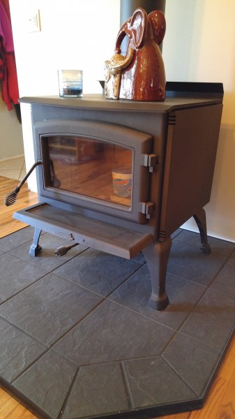

    I just zoomed in on the picture. That looks like my enerzone. 1472244230367-461913204.jpg So that fan must work.:D
