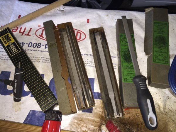

    I bought a lot of used double bevel files. Some were still useable but most are not. Does anyone sharpen files or know of a way to diy? IMG_2113.JPG IMG_2114.JPG

    Klye, yes! definitive dave can give you the info on where to get them sharpened. And BTW, you may very well get a bunch of guys askin' to buy some of them from ya. The straight across double bevels are very sough after ($$$$). The ones labeled Oberg = big dollars. Great find, I'd love to try one out myself!

    Don't get rid of the boxes.

    I meant in most cases an original vintage box is a premium item to have if sold/kept. :)

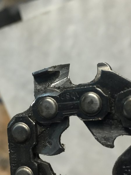

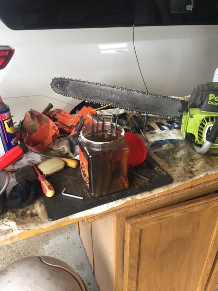

    So I will tell you what I did. I took 6 Nicholson files, cleaned them with soap and hot water then with carb cleaner and wiped them off with a rag. Then I soaked them in apple cider vinegar for 3 days. IMG_3195.JPG Then I cleaned them off with soap and water and then sprayed with WD40. It actually worked pretty well. I will definetly do some more. The file cut well and had good bite without being too grabby. I got a lot of my info from 1 post in this thread. Very good info.
    How to restore old files?

    Awesome....Xcept for the WD-40 part. Any file being used should be OIL FREE ! Period. Anything that can cause a file to "skate" ie. slip without cutting is as bad as dragging it backwards. Normal light oxidation "rust" actually sharpens files.... Just like your acid soak did.
    Kyle Mulligan likes this.

    Thanks for the tips! I will absolutely try some chalk on the files to see how it works. I just tried the wd40 cause the tread said it was a good idea but in the back of my mind I was thinking I was doing more harm then good.
