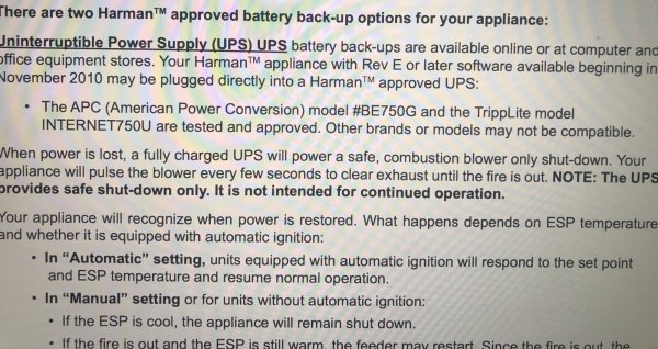

    I can try to track it down. I found it last night. Here is a screen shot from the owner’s manual online. Check out the first bullet point from the top. Sorry it’s a crappy pic.

  15. wildwest
    30,151
    141,433
    Wyoming high plains
    Yes, interesting, if power was out there wouldn't be any pellets feeding. Just what was already in the pot to burn out. Guess I'm comparing the house filled with smoke like WWW trying to start the woodstove in a strong inverted draft LOL.
