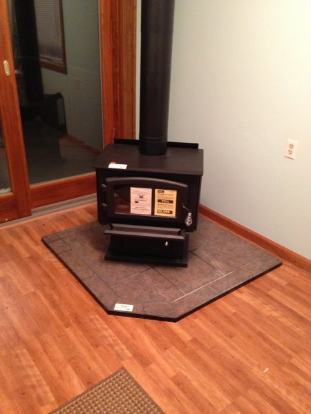

    He got Drolet to mail him all the information that he needs to present on Monday to the state and I believe the signed it too. We are even making a timeline of all that has been going on. As for pics o we got those! :thumbs: Im rather proud of the install considering the tight space limitations on his roof and house! :dex:

    Nothing fancy but defiantly good for the budget involved. He found the hearth pad on sale with a small chip and the stove at a great price! We even found all the Simpson Durovent at 20% off from TSC.
