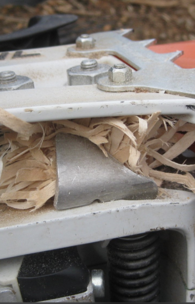

    My MS400 has an aftermarket clutch clover with double dawgs and chain catcher. I noticed noodles kept jamming up between it and the OEM one at a recent cut. Should i take off the OEM one?

    2 does seem redundant. Although, the aftermarket one kind of doubles as a stabilizer to stiffen up the larger dogs so they don’t flex. If anything, removing the OEM (and keeping it set aside) makes sense.

    Kinda my thought exactly. Just liked to get the FHC's 2c worth.

    I’d remove this one:
    The one on your dogs will do the job if called upon.

    Definitely agree remove the oem chain catch

    If you don't have the outer dawg, the case mounted catcher does the job. They sell them both ways it seems. Or a model shared clutch cover? Might need a couple washers to take up space as it looks like it's attached to the AV spring mount?

    I removed mine for the same reason and the noodles pour out now.
