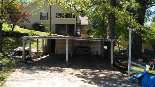

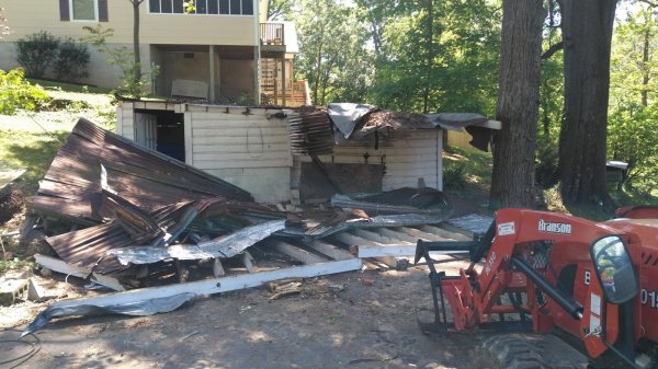

    Step 1: Demo Carport- Having a tractor made this step considerably easier. Also I have a city refuse collection center 1/4 mile from the house. So I ripped the thing apart, some dude came by to grab the metal and stacked the wood on a trailer got it to the refuse collection center in a couple of trips. Also that huge dying hickory came down too. $400 for a guy to drop it, cleaned it up myself.
    Step 2: French Drain- The back of the carport had a 3+ foot concrete block knee wall built around the back of it due to the existing grade. The back left corner would always get water in it due to what I imagined was at least partially water seeping through the block. This would not do for my new shop. Rented a mini ex and dug a french drain. Kinda sketchy digging on the slope but we got it in without incident.

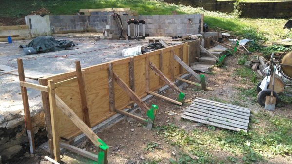

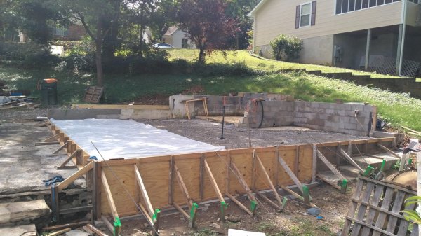

    Step 3: New concrete slab on grade. The carport had an old broken asphalt slab under it that dropped 13 inches from 1 corner to the next. That would not work for a stick built shop. 7 ton gravel leveling course to bring it up to grade. Then it was form time. The new shop would be built right up to the edge of an old 3' rock retaining wall. So to make this work the slab had to turn down and encase this old wall. First, using a concrete mixer I had to pour a footer for under the turn down slab. I had not really ever poured concrete or made forms but I know they had to be burly to withstand the weight of concrete. I did my best. I made one mistake that got REALLY scary during the pour. I imbedded concrete anchors in the footer that I used to bolt a 2x4 bottom plate to. The uprights for the form sat on those. The mistake I made is I didn't toe screw the uprights into the bottom plate. They bowed but did not break. PHEW!! Note to self: NEVER UNDERESTIMATE A CONCRETE POUR. I thought I had it, the driver even commented on how good it looked 1 minor oversight and it almost was a tragedy.

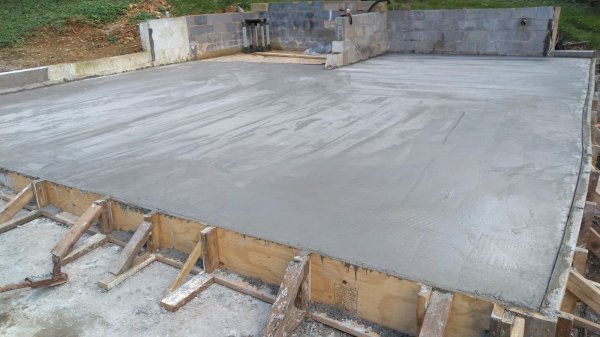

    SUCESS!! Check out that bulge!! I had never done a slab pour DEFINETELY not a 10 yard pour. Had 1 buddy with experience. It turned out pretty good. We ran 6 bags short, ran to Ace, mixed it up in the mixer and VOILA! My canvas was ready!!!

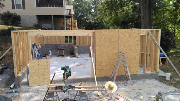

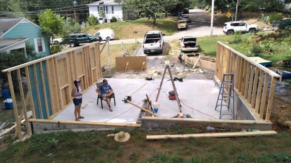

    July 25th: Wall day. Had 4 or 5 friends come help me get started. Of course I supply breakfast, lunch and of course BEERS! Here was our progress after Build Day 1
    July 26th -29th I spend by myself putting up the Front and back walls. The back wall was a bit more trick because I had to build it in place standing up due to irregularities in that silly knee wall. The front wall I built on the ground and picked it up into place.

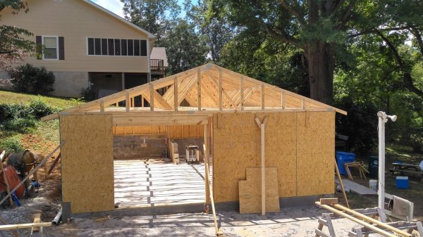

    August 1st - Had a crew of friends help with the trusses. A bit more expensive but SOOOOOO much faster! I bet we got all of them set in 2 hours. Thank goodness for friends!
    August 7th-
    A buddy came help me sling some roof sheathing and on August 7th, they day I was supposed to begin work we were dried in!! PHEW!!

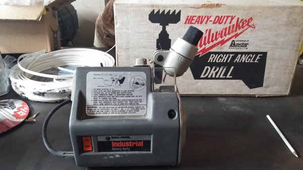

    Oh yeah and remember those tools I was talking about? Here are just a few examples:
    Old school Black and Decker Drill Sharpener, barely a piece of plastic on this thing
    Like new condition Milwaukee Hole shooter

    52,411
    Nice Build @ chris G, you got skillz!
    The concrete slab over my bridge has the same buldge (knew it was gonna happen with some jerryrigged forms)... but it was still a bit scary hearing those sheets of plywood creak, crack and pop.
    Looks like you had your forms braced perfect, did one of the kickers fail??

    Well I thought I had it perfect, but overlooked 1 thing. I imbedded bolts into the footer to attach a 2x4 bottom plate. But when I attatched the 2x4 uprights I forgot to tow screw them into that bottom plate. So as the weight hit it the plywood bulged out. Luckily I staked it well. The city inspector told me to park my tractor against it for safe measure, but I got cocky. Glad it didn't fail!!!
