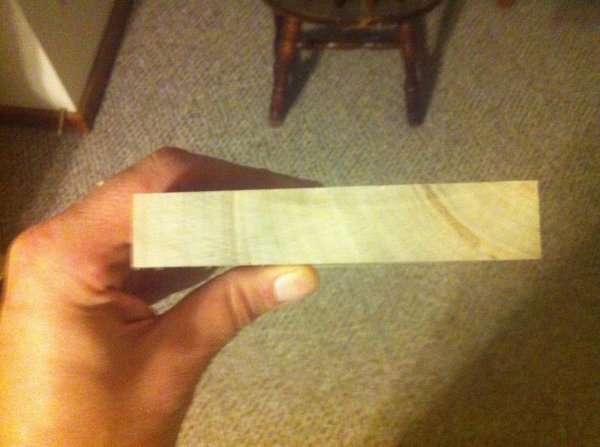

    Wow that thing is awesome! I've always wondered how the blade tracking could work on these homemade bandsaws. I also wonder if he can get enough tension on the blade by simply inflating the tires. On my vertical bandsaw, when I run a 1" blade, there's almost no such thing as too much tension - you really gotta crank it down or the cut can "wander" too much. One other thing - you usually don't lube a bandsaw blade - how's that working out? Not sure that's necessary - you don't want that blade slipping on the tire!
    Do you know what type of blade he used? How smooth is the cut? You can order custom-length Laguna "Resaw King" blades. Expensive, but they have carbide teeth, and the surface of the board comes out almost as smooth as if you ran it through a planer! I have one for my vertical bandsaw, and it's worth every penny.
    I have a bunch of logs that I want to mill up, but I haven't decided how I'm going to go about it. I have several options. I built a couple of roller tables for my vertical bandsaw, and a custom sled with a guide runner that slides through the miter slot. I mount a pipe clamp to the sled and use that to secure the log, then make a slice. It's a very tedious process though. My neighbor a few houses down has a horizontal bandsaw mill that hardly ever gets used. Dunno if I want to get involved with them though - on top of supplying my own blade and gas, they'll probably still want to charge me rent on the thing. But there's a local Amish guy who mills logs pretty cheap too, but I kind of want to do the cutting myself. I want to "quarter saw" the boards - they're more stable that way, and it can reveal some really cool "figure" in certain types of wood, like maple.
    The dream is to mill some of my own T&G hardwood flooring, to re-do my kitchen.

    Shawn, it's not mine, but we hang out often, so I'll ask him your specific questions next time I see him. I do have a good stack of boards from that mill in my garage right now, and they look great. There is a little "bounce" that leaves a slight surface chatter, but I ran them through my surfacing planer and it knocked 'em right down. I believe it's working very well. The lube idea he got from researching other mills, I will ask about that. Overall I know he's very satisfied, I hear it running all the time and the stacks are getting large. He's got the mill shed mostly sided in now, and his father's cabin is getting the same treatment.
    As for blades, he's fortunate to do maintenance at a fairly good sized manufacturing facility here, and they run a big computer controlled resaw. He gets all the cast off blades, and welds them to the proper length for his saw. They are all carbide tipped, and basically there's an unlimited supply. Great luck there! The cut comes out fairly smooth, but still want a run through the planer if you want a finished look. They definitely come out "rough sawn."
    That's a beautiful piece of wood in your photos! Would make an awesome kitchen floor.
