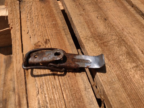

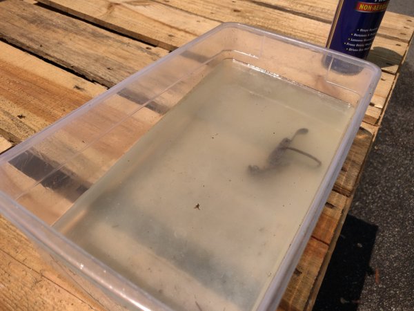

    If the rust is everywhere you can try soaking it in some 5% vinegar you can purchase at the supermarket. I did that to restore my vintage wedge as well as to restore some metal bits that were rusted to heck on these benches I found in the trash.
