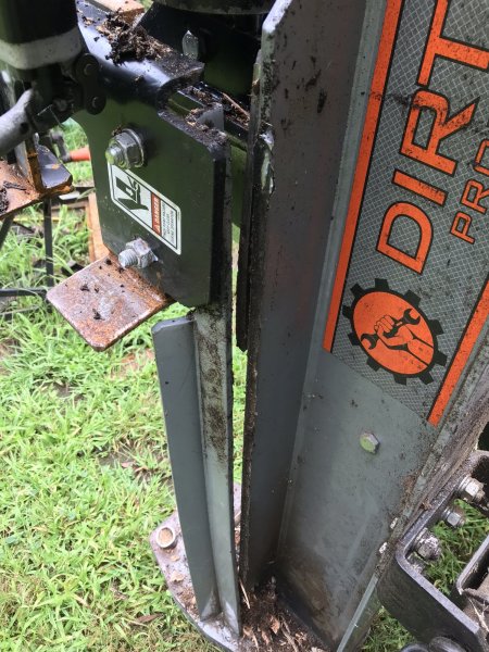

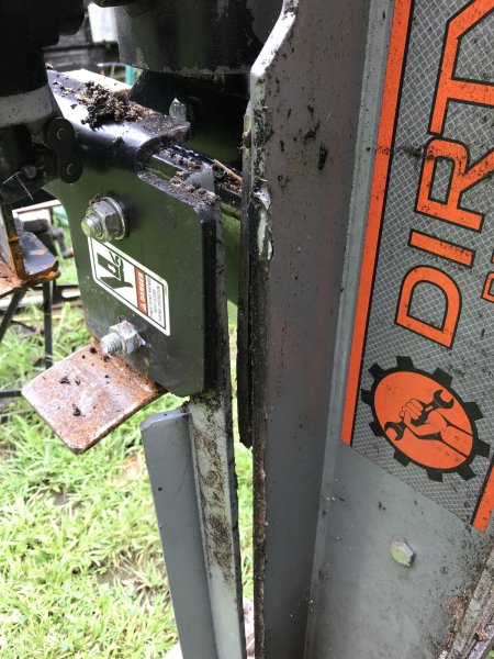

    5C5BD620-ECD7-4FF8-85B2-49E7D0878DD0.jpeg 674BE787-8B38-4C66-BD11-38794190006D.jpeg Had a little blow out today. I suspected it was coming. Saw an add about 2 weeks ago for a DHT and it had a noticeable hump in the wedge rails. I’ve noticed under great pressure mine moves a little. Was hoping to get a little more splitting done before investigating.
    Well today she popped. Just a heads up for you folks using these internal fixed gib splitters. It happens. Slight crack along the other side also. The welds didn’t fuse into both plates very well at all.
    Time to get the welder out. I’m contemplating welding more plates to the bottom wedge plate and make it a full wrap around gib style. The plate on my wedges bends up pretty good too. Just not strong enough for what I’m doing I guess.

    Design flaw or lack of quality control of the welder?

    Robotic assembly line welding strikes again. Not enough penetration. either too low on amperage or too fast across material- combination of each. yep QC. Have you contacted DHT ? ( not that there might be any warranty but ya never know)

    A little of both but mostly quality control. Probably a robotic mig weld on that joint. You know what they say about mig welding, produces a very pretty bead that holds nothing. LOL
    You can tell by the muddy dirty joint it’s either been broke for awhile or never really attached at all except for the shiny parts. One side of the joint is clean from shear. Means the weld never bonded.
    No luck on the warranty. 3 years in. I replaced at least half of this splitter the first year under warranty. Free parts I do the labor. No one will work on it for DHT.
    The engine runs good that’s a plus. Everything else is cheap overseas garbage.

    It is a full I beam. These pieces are welded to the full beam. Obviously just not good enough welds.
    These internal gib designs are not my favorite idea. There’s a little extra slop engineered into them. Might not seem terrible but once forces start pushing in directions anywhere but straight ahead things start breaking. The more slop the more twist the more forces generated sideways or up and down.
    I had built a four way wedge for it. The OE was poorly designed and fell apart. Realized after using it for a bit I would need to raise the ram higher in the back for it to work right. Took it off instead.
    May redo that back of ram height while I’m at it. I’ll see.
    Is gonna be ugly but it’s gonna be strong when I’m done with it.

    Welded it up this morning. Sorry didn’t take any pics.
    After looking at it again my idea of making the gib fully wraparound was out. The tabs that hold the guards are welded over on top the small angle iron. Totally in the way for my idea. Possible but would be a heck of a job to cut those two sections apart.
    I settled for just rewelding the angle to the ibeam. Some C and bar clamps to bring it all together and zapped it up with 6011.
    I’ll,save any dreams of further modification for another day. Got a lot of work for it to do now.
