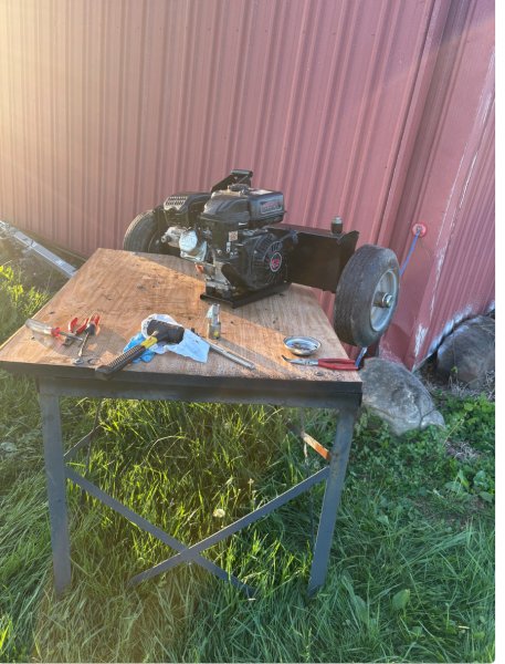

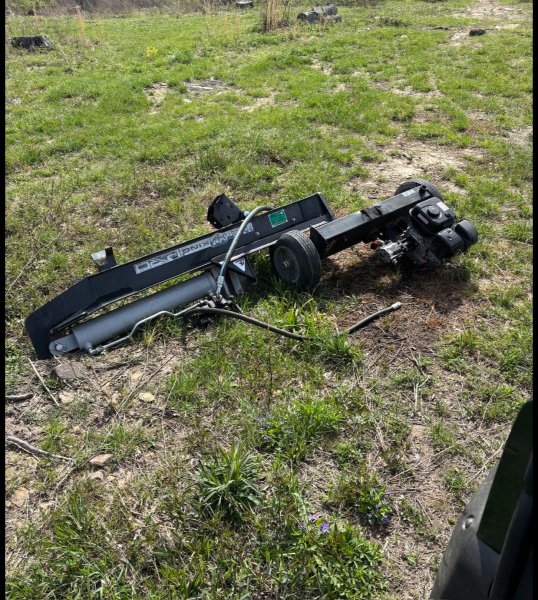

    So, last week i managed to get the engine mount snagged on an unmovable object. The I beam tore away, splitting the hydraulic tank. The channel bar that the I beam, and cylinder is mounted to was removed and repaired, thanks to a neighbor, i need to pick up a new trailer hitch tomorrow.

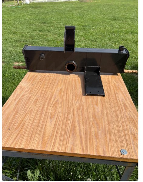

    Today, the new tank arrived late afternoon in a box suitable to place incorrigible grandchildren- let me know-. Unboxed and waiting on my recently fabricated outdoor work table with the frame out wood chipper was bolted to for shipping.
    next will be to tractor down to the crash site and haul the remaining parts and then piecemeal the engine, pump, and I beam/cylinder assembly.
    this unit is double in price from when it was bought. It was labelled as Forrest King at Menard’s , but a company called Foard’s must be the main importer that builds and labels them for wholesalers. Friendly people when i called to check on the status of shipping.
    will update as the reassembly proceeds.

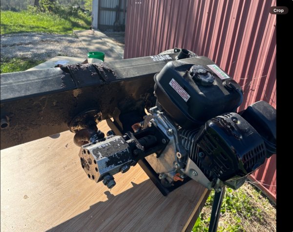

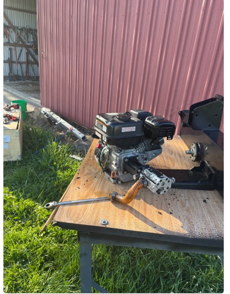

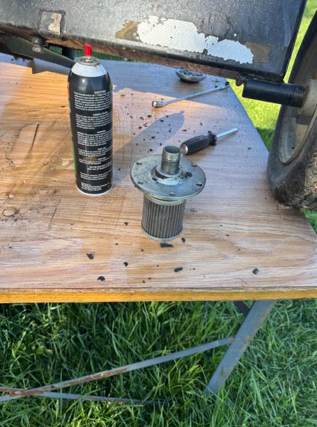

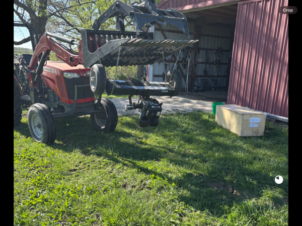

    After the rain and trivial tasks, i got down and hauled the old tank and IBeam /cylinder assemblies to the shop. Removed engine and filter.
    For some reason the hitch pin for the I beam mounting bracket will swing back and forth but wont pass through the old bracket. Might borrow a pickle fork from a neighbor.

    assembly for the tank completed after some hassle. Greased the wheel bearings before adding them to the new unit .
    Once i get the stubborn pin replaced it will be a matter of two bolts , a pin and attach the hydraulic lines , and should return to business

    Probably has grooves worn in it...might need to try to center the holes somewhat to pull the pin out.

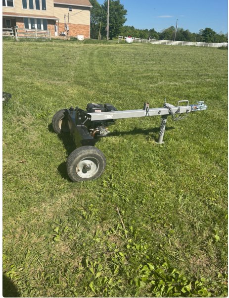

    double posted same i age earlier. Here we are with engine and wheels mounted

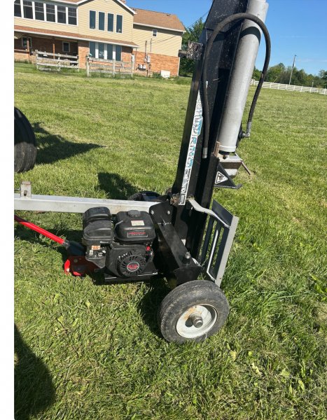

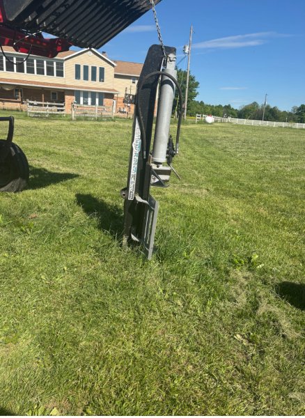

    Success in the reassembly! Even though the Predator engine was flip flopped and bounced, it fire immediately . It was suggested to me to raise the heavy upper assembly and maneuver the lower in regard to matching the upper, lower connection and running the pin through.
    all hydraulic lines reconnected, and a trip to Farm Supply for some fluid. Back in bidness. Hope you enjoyed another episode of “How Sourwood Breaks Everything He Touches “
