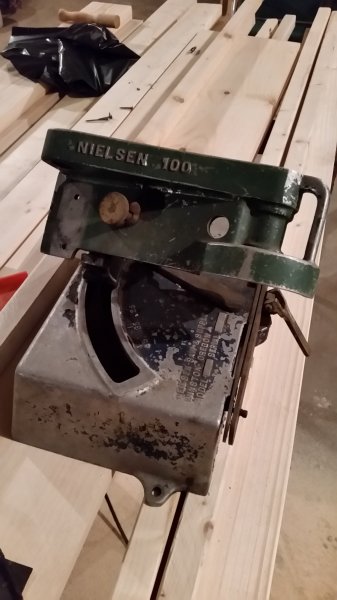

    I've got a great chain grinder that my Grandfather got when he started selling saws in the late 40's.
    I'm guessing he got in sometime in the 50's and it still works great on most any chain as it is so adjustable.
    I want to make a a nice depth gauge or raker fixture to make them all exactly the same and to be able to do it quickly. For years we've used the old standby lay on gauges and have gone through numerous ones as they wear.
    I have a surface grinder with a digital readout. I can easily hold .0002 tolerance which is way overkill for this but nice to have the option. :) My question is is there a good reference on the best configuration for a raker? I've always just tried to get them flat but is there any advantage to a slight rake? Portion Radii on the lead edge,? etc?
    Would like to have all the needs down before I start to make it. Have some ideas for a nice adjustable snap down holder and adjustments but open to ideas. I'll do a build thread if that intersts anyone.

    You can see the release handle on the back and you can grind any angle you want. Degrees are marked on the arc. Press the clamp to hold the chain and screw on the end sets you infeed on the chain. Even has a diamond dresser. Really a nice set up and was sold to dealers through Homelite at the time. Dad thought it was in the early 50's when they got as he hand filed chains for people at the start. When they started Homelite only had one model to sell.

    A properly profiled wheel on the Nielsen 100B is 55 degrees. The first grind will take a lot off the front of raker.
    They hold tolerance very well and are fast. All parts are still available, PM me for the contact info if you need anything.
    I love mine.

    Nice grinder Firewood Bandit.
    John Brooks Enterprises bought all of the old parts stock. He's not an internet kind of guy but very easy to work with.
    As I recall, changing wheels on the Nielsen is a bit more work than I preferred, but that aside I'd just buy an extra thick wheel and profile it on an angle to make it fit a raker top perfectly.

    Mr. Brooks is great to deal with and has all the parts. I bought a new pawl and raker wheel from him. I had adapted a dewalt wheel to fit and it worked. However this was extremely hard and although it worked it was not near as good a wheel as the one from Mr. Brooks that was properly profiled.
    BTW the nut that holds the wheel on has left hand threads. (don't fight it like I did):doh:
