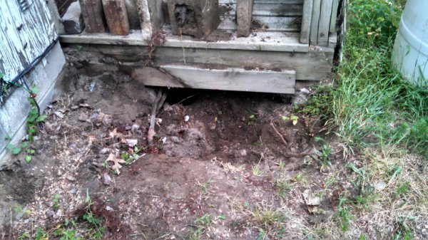

    So, the PO of this place had some stairs on this deck, and rain/chipmunks and whatever undercut any support. One of the stairs broke.
    What I'd like some advice on is how to best support whatever new steps I put in.
    Here's a pic of what's left. I can get better pics.

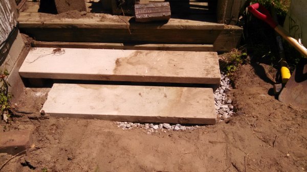

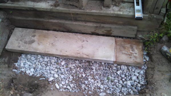

  8. papadave
    82,468
    This is a temp fix, but I filled about leveled, tamped the dirt, then about 4" with gravel also tamped down. This shows the original setup.
    Had some bricks that I put in the gravel, then laid a different slab on top.
    I'm still contemplating forming up for a small pour.

  9. papadave
    82,468
    One of the bricks that's under the slab. The bottom slab will probably come out and I'll just backfill with more gravel or dirt.

  10. papadave
    82,468
    Looking at this some more......I might pull those steps (a 10" piece broke off the small one), and backfill enough to just put 'em both back down level with each other. That would leave about a 7-7.5" rise.....perfect.
