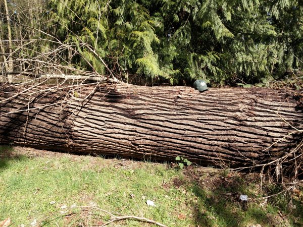

    I've got access to a very large black cottonwood that's already down. It's massive, about 5' across at the butt and doesn't start tapering until it get's about 40' up and starts branching. My large saw is an 038 Mag II and it pulls a 28" bar without too much trouble. I think I can get this bucked with that saw, but I'm curious how folks would tackle splitting it....

    Man that's a monster. I would probably noodle a bunch of it to make splitting easier but I really do hate noodling...

    In the very few instances where I have c/s split wood that big, I cut them 10" long so I could flip/flop the large cookies to the splitter ( nearby) to break up vertically as God intended.

    Id noodle it into manageable pieces, but only if you have a good use for a truckload of noodles lol.

    That big, if they flop into the ground flat then you’re stuck. Don’t let them fall on you and only tip them onto the splitter. If that doesn’t work then you have to noodle them into quarters for lifting.

    That's a lot of work for cottonwood.
