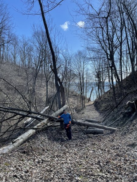

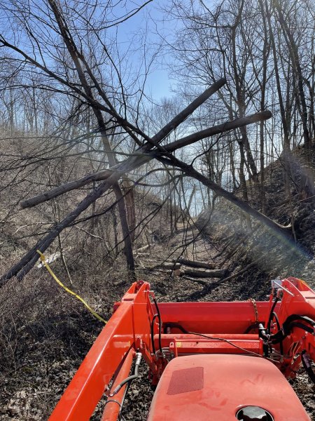

    So I posted a while ago about three dead ash trees blocking my lake access. Picked up a tow strap and a chain.
    I started by cutting a few pieces off each end of the uprooted/wedged trees. The shift in weight and they swung towards the ravine.
    I strapped the middle tree because it was easiest to access. But pulling it from the butt end got. me nowhere. Threw it over the other end and was abled to pull it down. That left two left hanging.
    I ended up having to cut the bottom one 90% of the way. D-oh, chainsaw got wedged. Strapped it up, crossed my fingers and pulled it away. The saw slid out unharmed. Strapped the top tree and pulled it all down.
    Before and after pics…including and underwear change!!!
    Jokes aside, I took my time and was methodical. And now have a bunch of nice ash. It was only punky at the root end, otherwise…solid wood.

    Nicely done!

    Bet that was a relief! Nice to have your access back. I don’t imagine there was any driving around that log jamb

    Great job getting it done. :thumbs: Hairy situation there and nice you had the tractor. Good on you for taking your time and working it safe.
    Yout woods reminds me of some of mine. Rugged terrain with good wood but not an easy way to get it.

    Situation like that would be a nightmare for me. Without hydro's, a come-a-long would have taken forever. Nice work.

    I was stressing about it. Since it’s in the ravine, I couldn’t count on a strong wind doing the hard work. Anyways my brother in law was there to help guide and be an extra set of eyes.

    Looks like a success. No doubt that orange thing helped you out greatly. Looks like a great setting and a big lake. Are you on Erie or Ontario?
