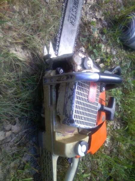

  16. BuckthornBonnie
    BuckthornBonnie
    974
    3,207
    Penn Yan, NY
    Had a crappy pic the Mennonite kid sent of the 1128 failure.
