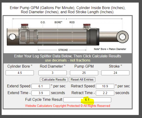

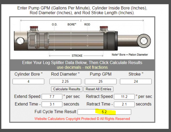

    yeah, I have a 40 ton (9.5 sec cycle time) and I don't need close to that tonnage. I literally can shear the wood and the pump never kicks down to the second stage. I hear the motor dig in and the thing just powers right through it. I don't even think I've seen even close to 500psi on my gauge yet either. That big cylinder really packs a punch. IMO, too big for a single wedge.
    If I replaced my 5.25" cylinder with a 4", this would be my cycle time:
    This would be the cycle time with a 4.5" cylinder:
