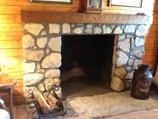

    The existing hearth is shallow and I am wanting to put my T6 in the VCs place. My dad said when the house was built a fireplace space was put behind the stone so it could be opened at a later date for fireplace use.
    I will pull the Vermont out and stick a camera behind the stove to get a view and also take some measurements. My idea is to have my T6 recessed into the fireplace which would also make the room seem more spacious. Maybe even upgrade to a large Woodstock stove at a later date.
    Will a concrete saw cut through the stone and concrete and leave a finished look? I would rather not have a cut look around the opening but I really do not want to remodel the whole hearth either.
    Any input would be appreciated.

    Went to the house today and took some rough measurements. The fireplace is 30" deep, about 42" wide and I am not sure about height other than plenty tall. There is plenty of room for my T6.
    My plan is to remove the Vermont and remove most of the stone from the middle of the hearth. Build a wood frame and put plastic around the hearth to contain dust and finish up the edges. I can paint the interior of the fireplace black and determine if I will leave the edge with cut stone or cap it.
    The T6 will get a blower kit installed on it and will sit in the fireplace space with around 10" sticking out. It will open up the room and give me a better heater to combat the propane man.
    I will post pics when the fun begins.

    The remodel is in progress. The mason said it is easier to take all the stone down and then rebuild it up as a fireplace. We started this morning and will finish it tomorrow.
    Here is a pic for size reference.
    The stone is going up. I am going to keep the height so there is better air flow and also I can use the stove to cook on if needed. If I ever go with a bigger stove I want the opening already planned out.

    "Big improvement.. :) You can't really see too much of the hearth in your picture, but that was replaced also?"
    The hearth was not replaced. The Vermont Castings that was on the hearth is rectangle shaped and my T6 is too square to fit on the hearth. Plus the fact it is a front load didn't help. The hearth couldn't be extended out because the space in the room wouldn't allow for that. The size of the opening will help with heat flow plus I am putting a blower in the stove to help.

    So you removed the large hearth and replaced it with the stone that you are standing on in the last pic? Made sure you had the full 16" out front right?
