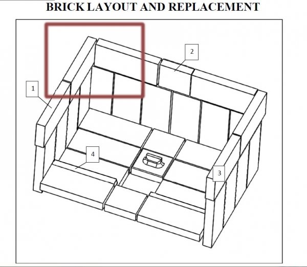

    If you removed the firebricks when you hauled the stove inside (to make it lighter) break out the manual and make sure that you laid the bricks back in their intended positions.
    Who knows? There may be a brick or two that is a bit narrow as compared to the others? Kinda hard to think that the manufacturer intentionally left a wide gap once they're all in place.......

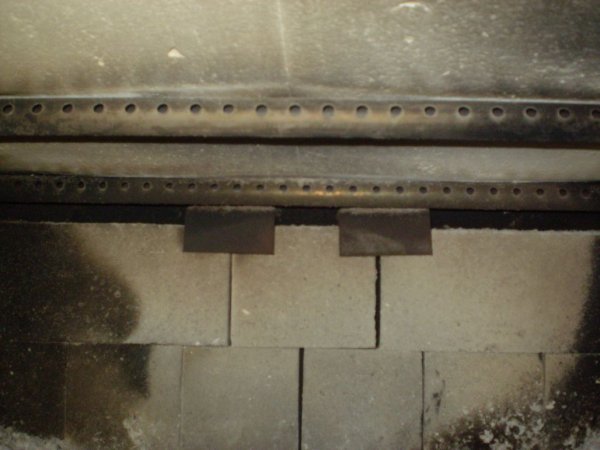

    That is true, I did take the firebrick out but placed them in the order I removed them; keeping the same pattern. I like my stove very much but there are a couple of things that I wish was different. I am including some photos; if you look at the layout, it shows the firebrick in the corner is butted against the one on the side. In the bracket photo you can see that brick is only held in place at the end. It comes out at the left end and I have to constantly shove it back in place to keep it from falling into the firebox. If they had used three brackets in the back, it would not be a problem. I want to make a wider middle brick and have the left corner behind the side firebrick to solve the problem. If there is another solution I am open to hearing it.

    For that little bit, why not just get some hi-temp stove and gasket cement?
    The pic does not really show a wide gap; I wouldn't be concerned about that. Chances are you may not get that precise of a cut on the replacement brick anyway.
    Now the black stained firebrick is an entirely different (but old) topic! I'd be more concerned about that!

    It isn't about gap, it is about those corner bricks falling out.

    I'd just cement the loose brick into place. A little dab will do.
