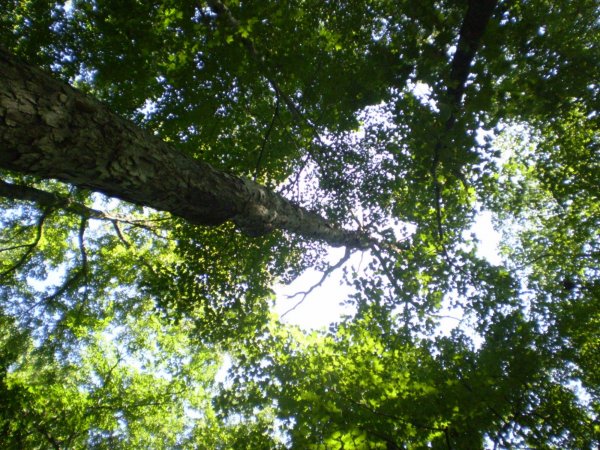

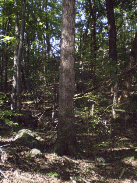

    Some photos

    She's a tall one......

    Yes, that is true; lots of wood in that tree. Diseased at the very bottom but not enough for any storm to take her down.

    Slap the bottom of the trunk with the back of an ax or maul.... Barcroftb & Shawn Curry know a thing or two about determining hollow tree issues....:yes:

    Tricky thing with that, at least from the pictures, might be getting it to drop with out hanging up in other trees. It is very hard to size up a tree drop without being there to look it over and I sure don't want to give you advise just from pictures.

    I noticed in the pics some smaller downed and leaning trees. Not sure what type of wood or how solid, but I have scrounged a lot of BTUs from smaller, deader stuff that others would leave as slash and trash!

    Dead trees can present additional hazards, as others have pointed out. You want to be careful with wedges too - if the hinge wood has begun to rot it's more likely to shear if you had to wedge it over. A rope would be much better.
    But it sounds like further study is in order - both of the tree and possible techniques. I highly recommend "To Fell a Tree" by Jeff Jepson. Every firewood hoarder should own a copy of that book.

    This is not a good candidate for you to learn on all by yourself. The wood shouldn't rot too bad while it's standing there dead.
    I would suggest taking a felling course. Or alternatively find a GTG and learn from someone there. There is also the option of taking a course put on by the International Society of Arboriculture or a Game of Logging class. If any are available in your area.
    In short that tree looks like a widow maker with a very small margin for a successful fall by a rookie.
