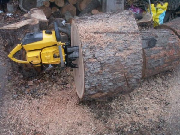

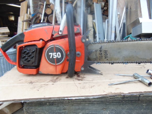

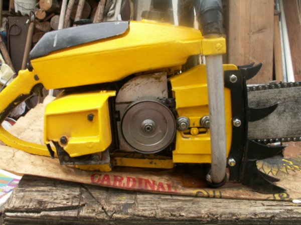

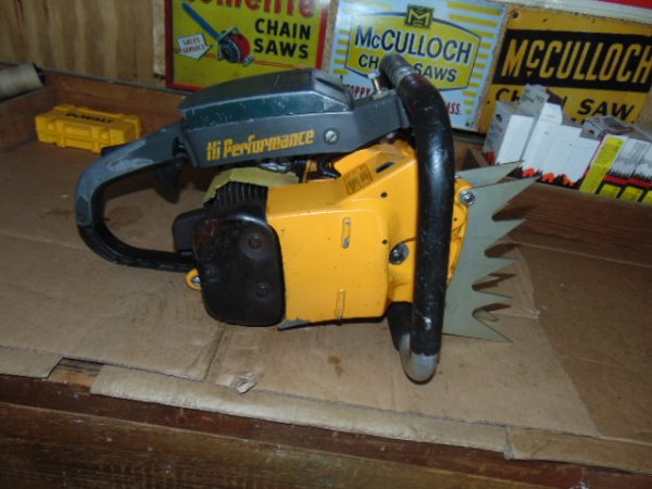

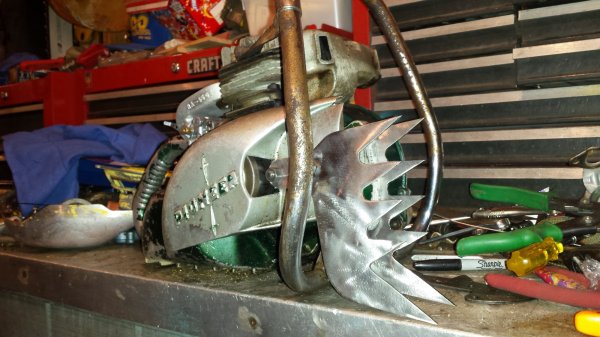

    Did somebody say "dogs"?
    These are kinda like PITBULLS......lol

    I "double dog dare" you to make dogs that are longer than the bar. LOL! I crack myself up.

    Those are evil looking...I like it.
