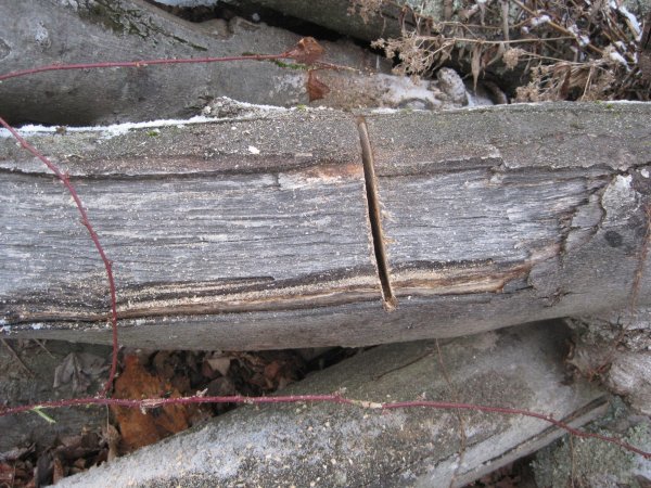

    Running the 22" bar on the 500i yesterday. Buck the first 18" red maple round and no problem. Started the second and it wants to cut to the right! Stopped and quick filing. Same result. Swap out chains and it cuts a few okay as i plunge cut instead but then curves again! Tried it on a smaller round and same result. IMG_0359.JPG
    Is it from the bar bent or twisted? Chains are sharp, teeth even length, rakers filed. Bar flipped religiously. It was cutting fine on similar sized rounds the day before.
    I have a habit of twisting the saw slightly when i finish a cut to separate the round from the log. I havent checked the bar.

    Can you take closeup pics? Have you measured with a micrometer? Every time I’ve had that issue, it was because the cutters on one side were removing more material than the other side. Even a couple thousandths if an inch of cutter length or raker height can affect it.. after several hand sharpening, I usually have to throw it on the bench grinder to straighten it out..
    if it started suddenly, it sounds like you hit something with the chain..

    I used to use a micrometer years back when i sharpened and later found out it doesnt make a difference if the cutters are off in length. If i notice teeth on one side are longer as its been sharpened many times ill give the longer side more strokes with the file. Im thinking i twisted the bar slightly.

    Hey more than likely its the chain to do that all of a sudden it takes a lot to bend a bar ,unless you have a lightweight one they are a little easier to bend I am not familiar with the 500i saw but does the bar interchange with one of your other saws just switch and see what happens but usually when it happens like that it is something you hit and if you nick the point on a full chisel chain it can cut off JB

    Anytime that's happened to me it's been because one side of the chain was duller than the other.
    Your hand filing should have fixed that though, unless it was really bad.
    Those logs don't look the cleanest...

    The log pictured were smaller 6-12" and stacked like a log deck off the ground. That was the top log and very clean. The bottoms were well frozen in.
