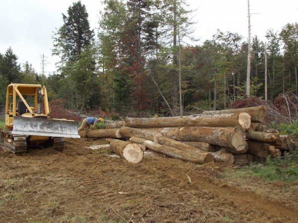

    Well I said I cut a load of ash logs and as is often stated, without pictures, it never happened. So here a few are, compliments of my patient wife who took them for me.

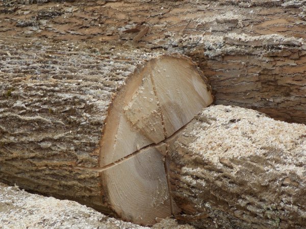

    Everything went well, with no barber-chairs on such highly valuable logs, however an interesting thing happened in the last picture. As I was cutting the last tree into logs on the deck it instantly cracked four ways. I have run into this issue before with internal stress in the log that just explodes when you cut into it with a saw. I am not sure if it ruined the 250 bf log or not. It scaled better at (4) 8 foot logs so its not like the scaler can take a 10 footer and cut it back to a 8 foot and call it good. Nope he'll either take it or call it junk. Too bad on a such veneer ash log 26 inches or so in diameter.
    As for the pile of wood in total, I'll let you know what it paid up at on Friday.

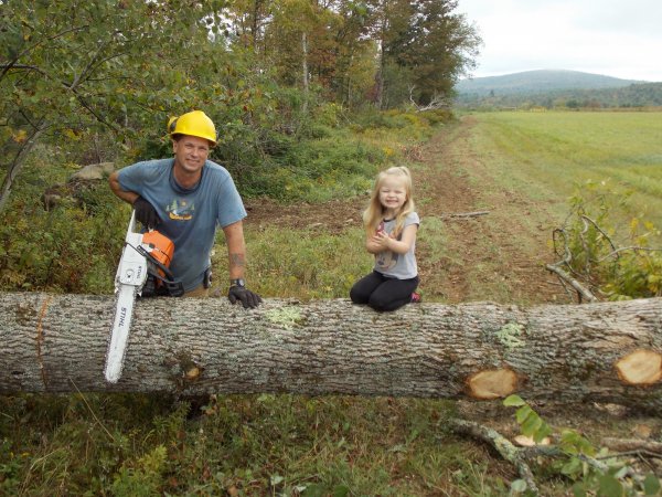

    I should point out a trick an old duffer showed me many years ago when cutting logs, but pulling them out tree length, or at least, more than one log at a time.

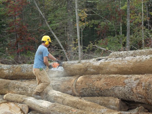

    In the third picture, the one with me and my youngest daughter, just to the left of my saw, you can see a saw kerf ring. That is the mark for my 10'-6" log with trim allowance. What I do is run my tape out to whatever length I figure will bring me the most money for the tree, then ring it and then start my next log. By doing that, you have a nice ring that you can find when you get out to the deck even after trees roll around from skidding. You can actually see this in the 5th picture. I am looking the log over for that kerf-ring to see where to cut the log at.

    That is nasty (and costly) when it happens but, it happens.

    The logs just left and it was not even disappointing, it was depressing. (4) of my biggest logs are junk due to that cracking. As my trucker and I talked, "boom" the darn thing split again! I also thought I had a load, but it was 3/4 at best. I am guessing I'll be lucky to make $700. :loco: :crazy:

    LodgedTree , I assume you were able to keep the cracked trees and are able to turn them into firewood

    Oh yes, my trucker knows anything that the scaler won't take, stays here, though it probably won't be used for firewood, but sawn on our own saw mill. It is crackd, and won't get good, wide boards, but it can still be quarter sawn and it is clear wood without a knot in it.
