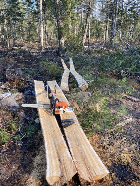

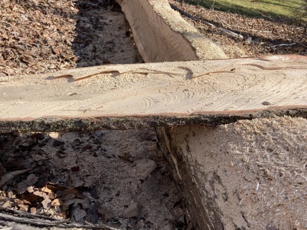

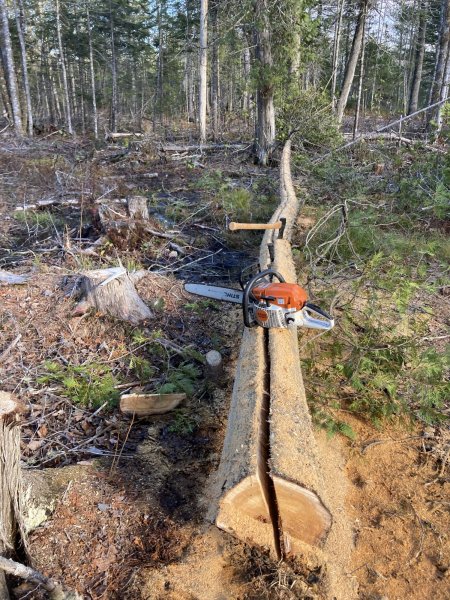

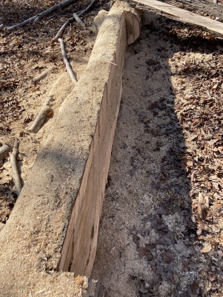

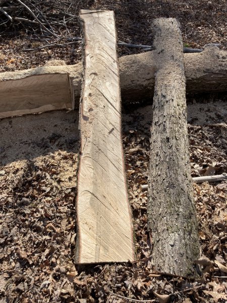

  11. Paul Dokken
    Paul Dokken
    Jan 1, 2021
    137
    424
    Waxhaw NC
    Here are the results. Not as nice but I will probably get better as I go.
    One YouTube video showed a guy using a level mounted on his saw. I might try this.

    I don’t think that looks half bad for a first try… Ever look at rough hewn beams in a 100+ year old barn? Yours looks nicer. Of course those guys were making beams on site with hand tools:whistle: But let’s be honest a chainsaw isn’t generally thought of as a precision cutting tool.
  13. The Wood Wolverine
    17,937
    113,935
    I agree with Brad 100%. That’s not bad at all for a first try, or even a 5th try and beyond.
