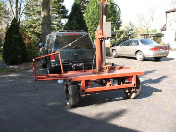

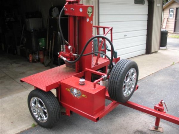

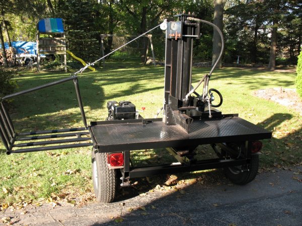

    I have built 6 vertical table splitters in the last 20 years with patience in acquiring components and my own labor the most I spent was $1,500.
    splitter robin engine 002 (Small).jpg Beefie splitter 020.jpg Copy of splitter details 001 (Small).jpg
