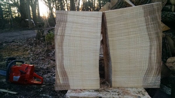

    I had to go out and cut one. IMG_20160328_195452967.jpg IMG_20160328_195447774.jpg

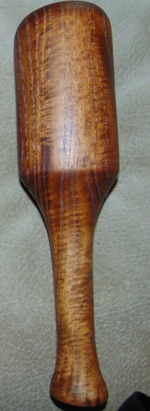

    I had a large ash tree taken down on my property a while back. Just got into the splits and noticed some of it was curly so I've been setting aside usable pieces. First thing I made was a chisel "hammer".

    What is this used for?

    Go to 10 minutes 30 sec into this vid.
    Pretty much hammering tools you do not want metal to metal contact with.

    The Wood Wolverine it was your tool handle thread that got me looking for this. Do you think this would turn out similar to yours?

    Can't see why not. You have to do a little research on how to accentuate figure. I use analine dye, "sanding" lightly with fine steel wool between coats (usually 3), then the mallet got a boiled linseed oil for a finish. I have a few recipes I could share if interested. The best one is attached. It's a bit long, but if you're building fine furniture, It'd be worth it.
    The main issue with making your own boards is preventing splits/checks/cracks and getting them to dry straight and flat.

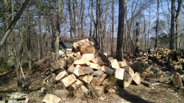

    The Wood Wolverine this is the kind of information I'm looking for. Never would have thought to use dye. Looks like you have quite the pile there yourself. I wish mine were longer. I didn't notice till it was too late. This is where the pieces were when i noticed them. IMG_20160326_141537029.jpg
