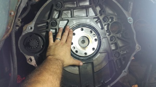

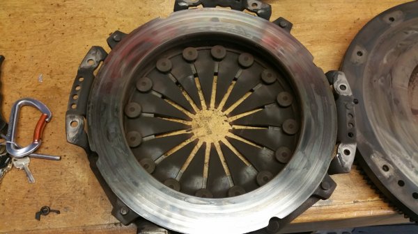

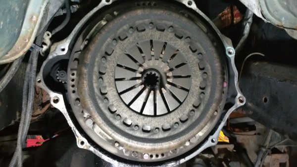

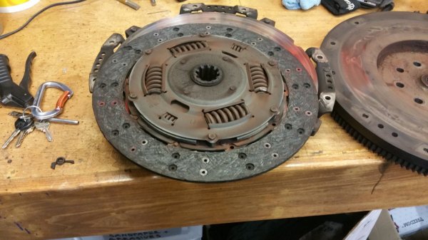

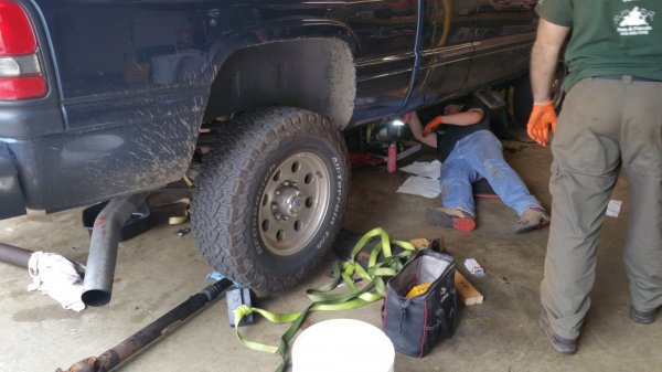

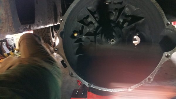

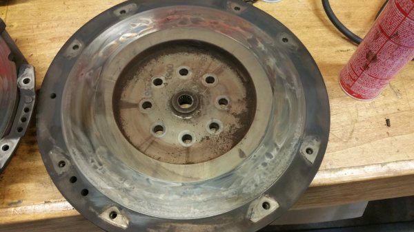

    I wish I took more pics but I was pretty busy. My uncle and a close friend helped replace the clutch in my 01 Ram 2500 with a 24v 5.9 cummins and the 6 speed NV5600 trans. The clutch has been slipping for about a year and a half but got really bad in the last 3 weeks. Everything was pretty smooth except getting the cross member out, had to use a bottle jack and wedge the frame apart.... not fun. And getting the trans input shaft into the pilot bearing was a bear. Took about 2.5 hours of wiggling, jacking and brute fore to get it in.... Tomorrow we need to reinstall the cross member, not looking forward to that, and reinstall shifters and drive shafts. Here's the few pics I have. Note the rivets on the linings. They shouldn't be shiny and the discoloration on the flywheel and pressure plate isn't good either....
