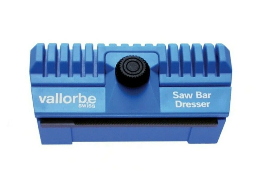

    Where do you get one of these

  11. RCBS
    RCBS
    Jan 22, 2016
    5,678
    27,904
    Over here
    This is the one I have. Only used so far on one bar but it got things squared up. The pferd one is kinda pricy. There are others on Amazon.
