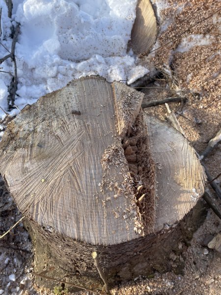

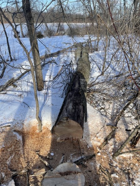

    So I fell a dead ash tree, but not without a bit of extra work.
    It was leaning and should have been easy. But I think I messed up the hinge. I’m thinking back cut was too low. Btw to drop it I used wedges, my hookaroon and some elbow grease.

    It looks like it went where you wanted, since it's laying in line with the face cut. It's hard to tell some stuff due to orientation of pics, hard to tell height of backcut. But the front of hinge has an angle...it should be a straight "crisp" line/cut. I've always considered the face cut side of my hinge very important and will true it up if anything gets buggered.
    The backcut side of the hinge has that triangle piece at the top of the first pic, not sure what happened there. Is that about a 10-12 inch tree? Did you bore cut after the face cut, or just come in from the back with the backcut?

    Yeah it’s maybe 14”. And no bore cut. And to be clear it didn’t fall when I cut. I had to wedge and use my hookaroon as a lever.
    The triangle I think is because I cut through the hinge on one side.
    I think I do need to do a a steeper angle like BuzzSaw says.

    That tree being dead, the back cut and bottom of the notch should be on the same plane. That hinge needs to split to fall the tree if the back cut is way higher, which will take a lot more force hammering a wedge. Also make the notch more open so the tree can fall further before closing.

    Unless I'm missing something, we can't tell how open the face cut was based on the pics provided. The bottom should be flat if on flat ground, or mimic the slope if not.

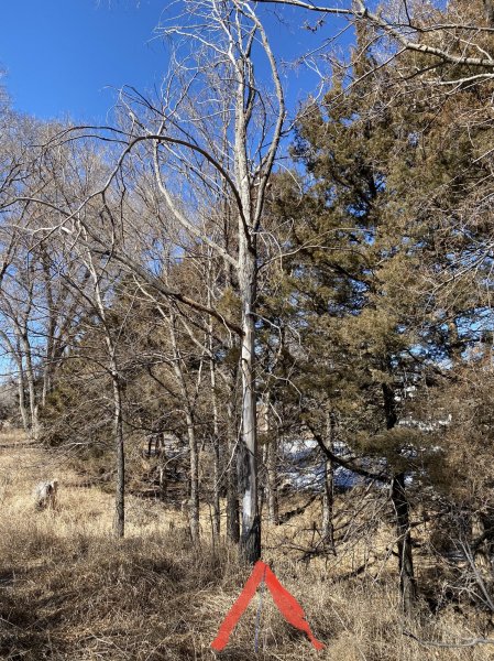

    I have a similar one to deal with soon, maybe even this afternoon. Standing dead elm maybe 10-12” at the base. Pretty straight with almost no discernible lean or top weight. What tiny bit of lean is opposite of the way I want it to go. Gonna try and wedge it the way I want but not much room for wedges after the notch and getting a good start on the back cut. Not much of a problem if it doesn’t go as planned, as long as I get out of the way. Might hang up in some other trees but I should be able to get a chain on the butt and pull it out with the pickup.

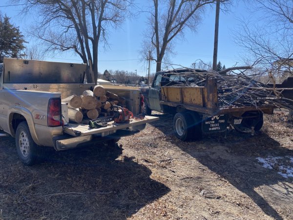

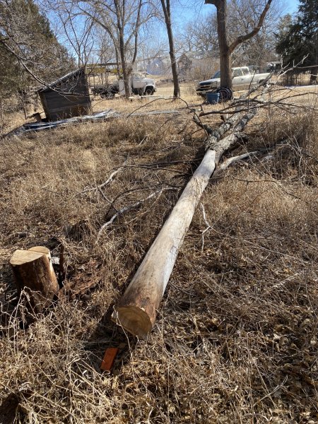

    It went perfectly, almost like I knew what I was doing. 1FBDDE06-74A5-4F69-BBDB-D6B2453203A7.jpeg E7364448-91F1-4E3D-BF5C-B984B98481A1.jpeg ECCEEA0D-2539-41BA-8C3A-2ACBE208652A.jpeg Not much of a score really, only 9” on the stump. But I was only on site barely an hour and 1/2. His dump truck was only about 75 ft away so that made cleanup go pretty quick. 357xp got the call to duty today

    1. I'm looking at that slice you took out of the face cut wondering if what you've been saying all along is "The face closed up, but the tree stopped falling at that point."???? If that's the case, or even if not, yes, make a (much) wider face cut. It would account for that odd pie shaped cut at one o'clock on your stump anyways. You used a hookaroon to get it on the ground? What???
    2. I agree with all of Eckie's observations and advice 100%. Everything just needs leveled out - and that comes with practice. That face cut especially - needs one straight cut from one side of the hinge to the other - that was fixable - and should always be fixed.

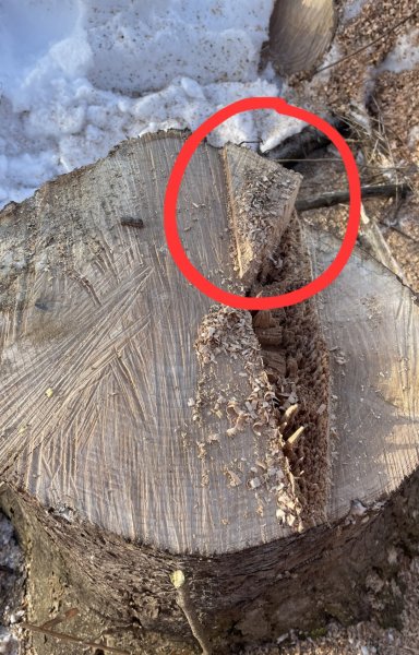

    You went a tad deep in this one spot...... Screenshot_20220226-181121_Chrome.jpg
    I'm not beating you up, just dropping an honest assessment. The rest of it looks good.
    When you take too much ot of a section of your hinge (namely on the outer edges) in some species or trees in certain stages of decay, it can steer the tree in an unintended direction. Take the extra time and pay careful mind to your hingewood....
    Your back cut is properly above your face cut, that's where it needs to be. And your face cut is approx 1/3 the diameter of the tree, which is the standard in most instances....
