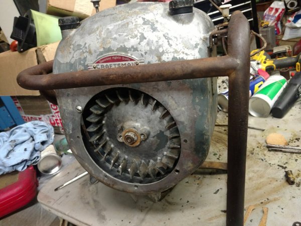

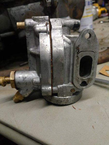

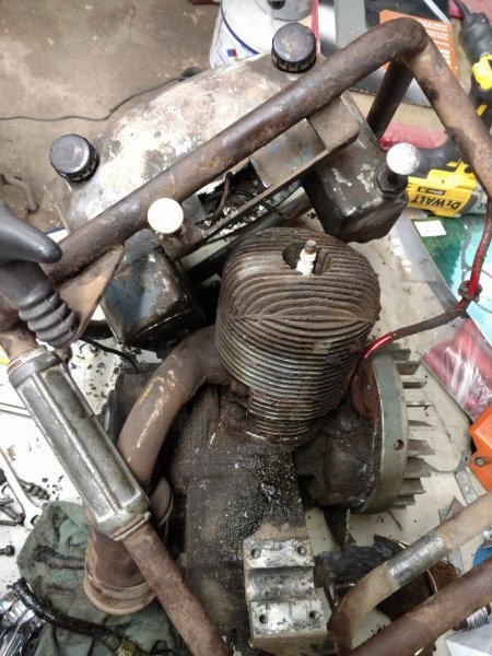

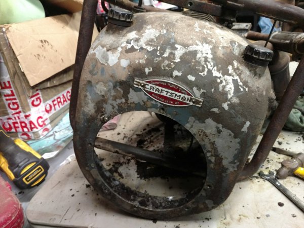

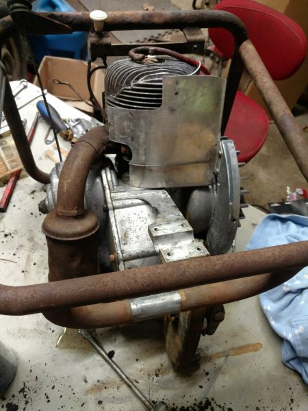

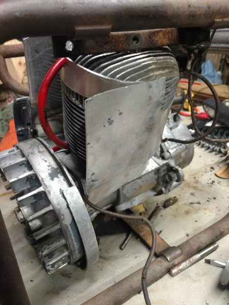

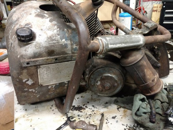

    I acquired this saw a few months back. They were first sold as Reed Prentice then sold to Craftsman and David Bradley. 103cc engine built by McCulloch. It would run but not rev up. They fuel system is all gummed and the carburetor was the darnedest thing to get to and like none I have seen. Hopefully in a few weeks I can have it running well. Don't mind the mess in my shop and on the saw. A few hours in the ultrasonic cleaner and hopefully it will be good and clean. IMG_20170416_201752413-2137x1603.jpg IMG_20170416_201737450-1603x2137.jpg IMG_20170416_201727728-1603x2137.jpg IMG_20170416_201528752-1603x2137.jpg IMG_20170416_201717630-1603x2137.jpg IMG_20170416_201803409-2137x1603.jpg

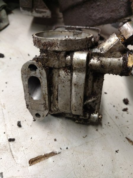

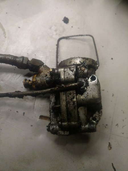

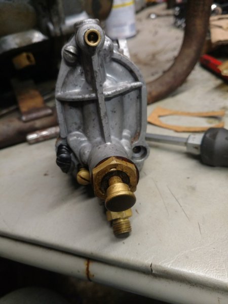

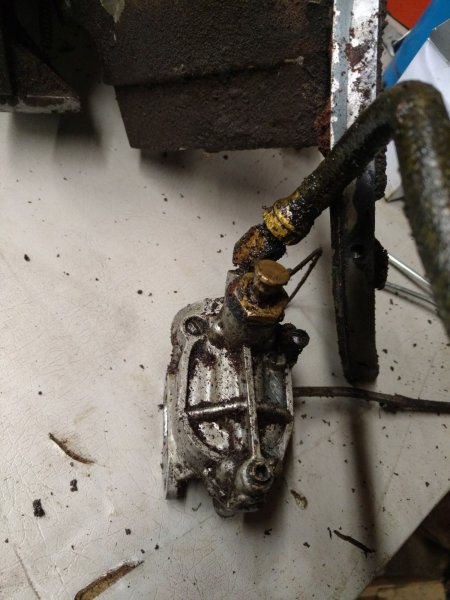

    IMG_20170427_191221128-2004x2672.jpg IMG_20170427_191236931-2004x2672.jpg IMG_20170427_191249750-2004x2672.jpg IMG_20170427_191300200-2004x2672.jpg IMG_20170427_201610050-2672x2004.jpg
    After everything that would fit took a bath in the ultrasonic cleaner the rest was degreased and pressure washed it's starting to go back together. I had to make a few new gaskets and soak the diaphragm in brake fluid I'm hoping it will run.
