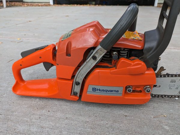

    I found a Husqvarna 350 (yea yea, homeowner saw. But for here in Wyoming, I think it's the perfect saw for Lodgepole cutting) that looks brand new. One owner. He mentioned that it needed crank seals because when he goes to full throttle, it dies. I inquired further about his comments and he wrote: "I had it into a mechanic because it would kill after throttling it up. He rebuilt the carb, but that did not fix it. I have owned it for 20 years. Evidently, the crank seals get brittle and fail over time. This can cause the engine to run lean, causing it to run hot, leading to the wear on the pistons. The cost of the repair for me was not worth it. Crank seals are cheap, but not the labor. If you are mechanically competent and can replace the needed parts, this is a good deal."

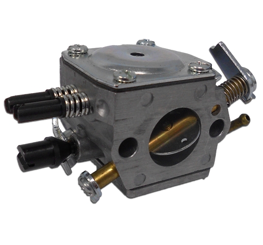

    Looking at the saw, it's been replaced with a chinese replacement carburetor. To me, it's not getting fuel. Either the fuel line is cracked, the impulse line is cracked, or there is an obstruction in the carburetor, or improperly tuned.
    Thoughts?
    Second question on a 350, I recently have had an issue with the chain brake. It's as if the side cover has tilted outwards on the top and when you go to release the chain brake, it slides past without disengaging. You have to hold your hand on the cover at the top and then it grabs correctly. I cleaned everything and it still occurs. Is it possible the chain brake itself is the issue (maybe the plastic tabs have rounded over on the chain brake area) OR is the bar cover somehow bent?

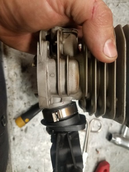

    If the riser base screws are #1

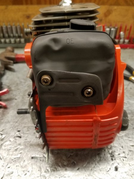

    #2 would be the muffler screws. They come loose, allowing hot exhaust gasses to melt the case. Either remove them and use Loctite, or mod a 346 muffler bracket to solve the issue. Most guys use the bracket.

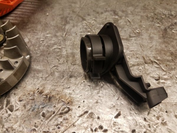

    #3 can be the plastic clamp for the intake boot. Get yourself a metal clamp and replace the plastic one.
