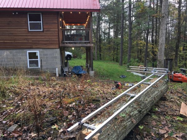

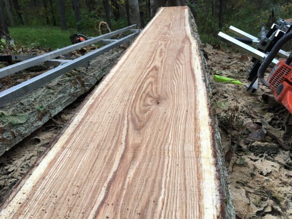

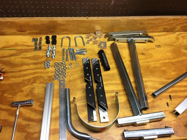

    Got the mill all put together Friday night. Looked like a mess of parts but set everything out and took my time and it went together easily.
    Got out to camp Saturday morning and of course it’s raining pretty much all day but I couldn’t let a little rain get in the way of this. It’s been a couple years in the making so needless to say I’m pretty excyabout this. We originally went out to the woods a ways and skidded a wind blown beech back to the cabin. It was so muddy though I decided I didn’t want to use that one. There was a really straight standing dead oak (red I think) close to the cabin that needed to come down so I dropped that one and decided to give it a go. Maybe I should of tried a pine or something softer for my first attempt but this was close and easy. Came out fairly good. Take a look.
    Little bit of punk on the edges but not bad. It honestly worked way better than I could of imagined, had a huge grin going.

    Definitely a trial and error type process. Learn a lot of tricks the more you do it I’m sure. Set the depth at 1/1/4” and it is really accurate through the entire board except for the end where I finished. Got a bit of a wave on all the boards I cut right at the end where I finished the cut. Now I Just have to figure out how to properly dry the wood and file chains the best way for milling. Any tips or advice is greatly appreciated.

    Awesome log to lumber pics!! That’s the best part, opening up and seeing what’s inside.
    If you file round, use 10 degrees. If you’re square filing I have good success with about 15-20. Adjust rakers to your powerhead and wood type.
    Two thumbs up bud, that log is purdy! Sticker it up out of direct sunlight and paint those ends ASAP.
