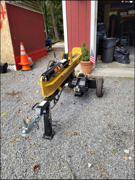

    Just came across this ad on FBook marketplace.
    “Bought this in March used it to split wood at my house, left it outside for a few months and it won't start, doesn't run on starting fluid, I don't have time to work on it, but it's brand new”.
    I’m most likely going to keep it outside too. Should that be a problem? …or a simple fix?

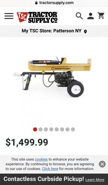

    Looks like the cost of this one new is $1500. I reached out to the seller. Waiting to hear back.
