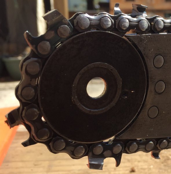

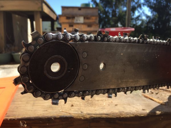

    It's all about the chain...
    How soon is the event? Maybe you could borrow a loop of play chain.
    Chaz, Chvymn99, T.Jeff Veal and 8 others like this.
  3. The Wood Wolverine
    17,285
    108,528

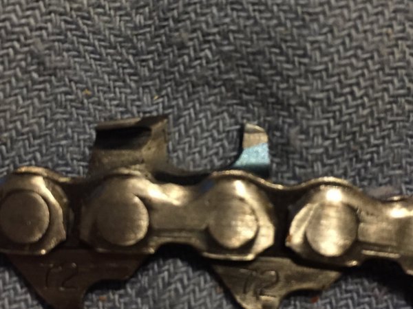

    Square filing is a way to sharpen full chisel btw. :saw: Those chains are full chisel as apposed to semi so imagine the #7 (full chisel) vs. a ? (semi chisel).
    Chaz, Chvymn99, T.Jeff Veal and 6 others like this.

    Yup,
    Chisel chain has two profiles, round ground or square ground.
    Round ground is sharpened with a conventional round file or grinding wheel.
    Square ground takes considerable expertise/skill to do well. It is done with a special file or specialty grinder.
    How To File Square Chisel Chain
