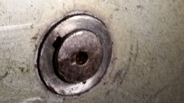

    I blew a bearing on my snowblower where the shafts goes through the scoop to the impeller. I took the scoop off to access the wheel for the belt. I am having a helluva time removing the belt wheel off the shaft. There were two set screws on the back of the wheel. One was snuggled right tight into the top of the key. I have the set screws removed and the wheel is plenty loose.
    I am thinking that the set screw raised the metal on the key and when the wheel is pulled off the shaft, the key is jamming.
    So any ideas on what to do next? I was thinking of drilling out the key from the end. When the wheel was almost off, I tapped the key back in but it dented a little. I don't have a wheel puller.
    Picture of the wheel pushed in. End of key showing. I just think the key is hanging up and pulling the key causing it to wedge.

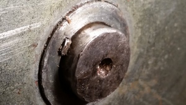

    Wheel out. So close. I cleaned up the mushrooming from the hammer on the shaft end, most likely not the issue.

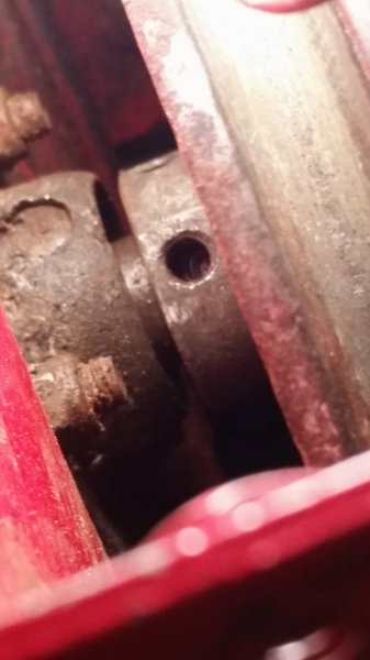

    View looking down to the set screw hole where I think the key got puckered.

    I am going to try to use a small steel rod down the set screw hole and flatten the pucker down on the top of the key.

    I don't think it is mushrooming. I went around the end of the shaft with fine sandpaper and it still made no gain any closer to the end. If I lowered a high spot I would expect to see some gain moving towards the end. I just think the key is puckered at the top at the set screw hole. One more bourbon egg nog and I'll go back to it. I may drill it out at this point.

    Most of those pulleys will not stand up to a puller of any kind without some serious distortion. Pickle fork is a great option if you have enough room to get one in between the housing and the pulley. IIRC they aren't real expensive for a hand-held one from an auto parts store or similar.

    Put two chisels down both sides of the shaft. Then drive each one in like a wedge taking your time and make them even. That should eventually drive it off.
