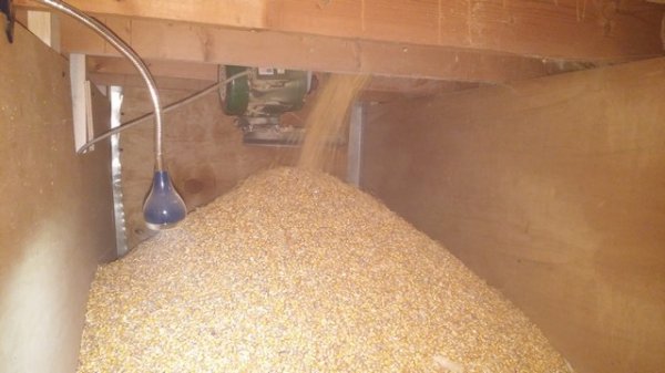

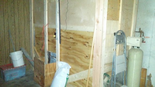

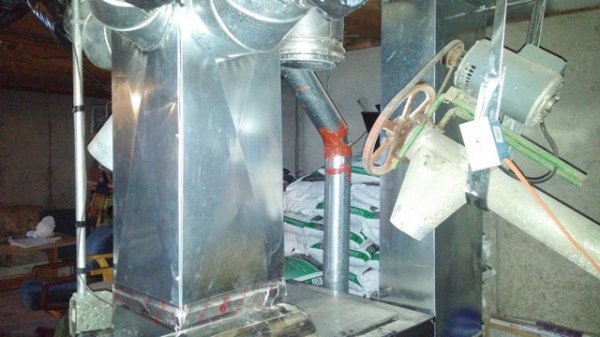

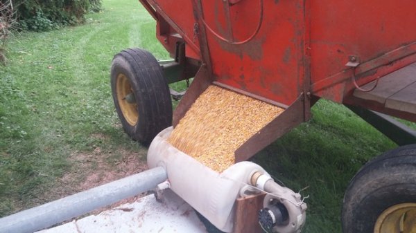

    I burn mostly corn as the price is very low in the area we live in. $100. a ton for the last few years.
    I'm not a spring chicken anymore and my wife has a 25 lb lifting limit so we decided to automate the corn handling chores to some degree. We used to store corn in 50 gallon barrels however it was a lot of manual labor handling the fuel several times. Corn.jpg Corn1.jpg Corn2.jpg Corn3.jpg
    I thought I'd share some pics of what works for us.

    Wow!!! That is a sweet setup you have there :thumbs:

    Thumbs up on the above system! I wish I had the extra room in basement. You found a way to help you handling the fuel to a T which is the way to go about doing things:thumbs:

    Slick setup. How well does the blower on the barrel help with the fuzzys?

    Blower helps a lot, (if you look on the far side of the barrel you can see the junk)
    Cleaning the corn is still a bottle neck and needs to be improved on you can't see it in the picture but there is a screen in the barrel as well as the blower.
    I have a Corn Vac however it is very slow, It took me over 7 hours to unload the wagon with it last year, this year using a 4 inch auger with the screen and blower it took an hour and a half. However I would like the corn a bit cleaner. I purchase corn from local farmers some is clean enough to put directly into the furnace some needs a lot of cleaning. Just depends on the combine and operator.
    The Corn Vac gets the corn real clean, The bag in the vacuum plugs very quickly, I would say about 300 lbs and you need to clean the bag and vacuum.
    Also you need to constantly fiddle with the pickup hose, if it is to deep in the corn then the air flow is restricted and the corn doesn't move to high and it sucks the corn up and then nothing moves, also the screen in the corn vac plugs up quickly if you have very much light stuff in the corn. also it takes a LOT of vacuum to make it work.

    Could you alter the chute on the gravity wagon to get more drop and add a blower fan there?
