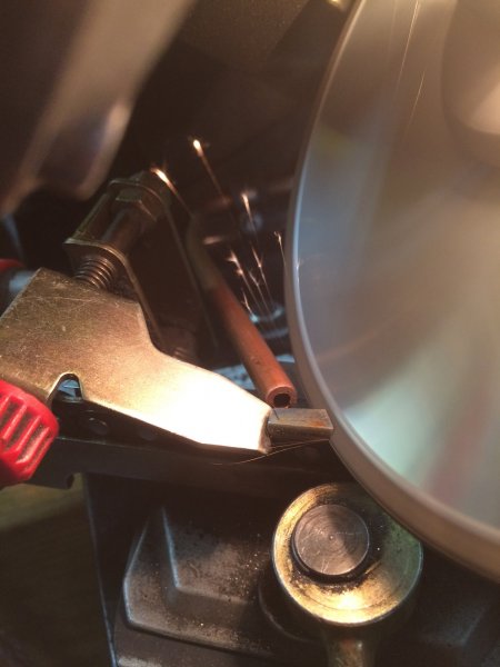

    I have an Oregon 511A chain grinder that I already made reversable. I have been using the pink wheels and wasnt happy with the heat that they were putting into the cutters. I was forced to slow down and use time if I wanted a cool, unheated cutter, so I started war gaming an idea on how to cool the cutter.
    Then I saw a CBN wheel for under $120 to my door, so I went for it. I like the wheel ALOT, but on a rocked cutter, I generated enough heat to start blueing the cutter. I admit that I was very heavy handed, but I had the tree guy standing there waiting. I told him that it would be a little longer due to the rocked condition and the heat being generated, so he said "keep the old chain and can you spin me a new one ?"

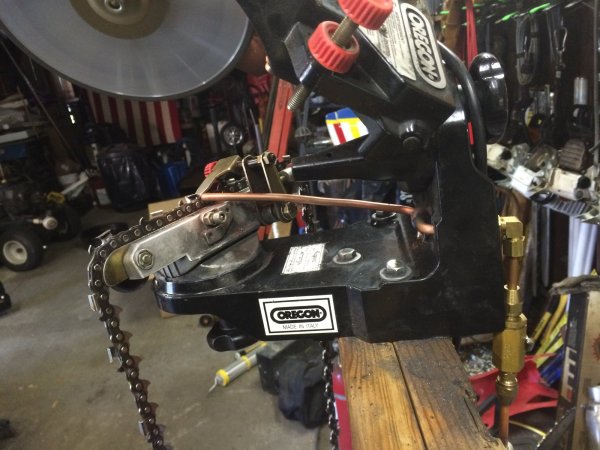

    I had an hour or so left to kill before work, and while everyone else was sleeping, I went to the barn and got started. The end result is a simple tube that blows cold air right at the cutting surface. Set it for the chain, just like the stop, and go around without touching it again. Switched to the other cutters and I still didnt have to touch the tube. :thumbs:
    For me, it was simple enough to use air, I didnt want any water getting all over me or the grinder, and this works pretty well. I included a valve to controll the air from the tube, and believe it or not, I didnt need alot of air to do the trick. I intend on switching to a pink wheel on a junk chain just to see if it can keep that cold as well.
    Have a look ........... first picture is an action shot too !!

    Cool invention. Ha ha.
    I just bought the same wheel and I have the cheap chinese knockoff of your grinder. Just used it last night for the first time.
    I recently saw a video of someone using these grinders. He used more of a tapping method by continually raising and lowering the blade. Ha, that's what I've been doing wrong. Takes longer but so far no heat problems or molten slag dripping on the floor :)
    The worse rocked chain I did last night only needed .030" removed so perhaps not the best test. I do like the blade tho, great investment.

    I would neck down the tube to increase the velocity.
    Eric VW and Moparmyway like this.

    How much chain dust is getting blown on you?
    clemsonfor, Eric VW and Moparmyway like this.

    I was thinking the same thing. I always wore safety glasses. But I can see fines being blown all over you.

    Actually, none.
    The air is coming at an angle to the side and upwards, no matter which direction the wheel spins, I stand off to the side and dont even wear glasses. Its not alot of air pressure at all .......... cant even feel it blowing on me.

    Hardest item to procure is the valve. Everything is standard refrigeration tube and fittings except the compression elbow and 1/4" pneumatic fitting. If I had to make another one it would only take me about 1/2 hour since I have the angles and shape figured out already. I would also adapt a smaller tube to the end of the main tube, might be able to come across some capillary tubing that would be perfect. If you want, I can take more detailed pictures so you can war game your thoughts and come up with something that works perfect for you Sir.
