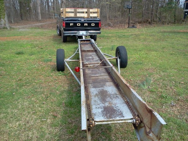

    OK, I have been looking for a conveyor for a while. Due to the cost of a firewood conveyor I went the route of a hay conveyor. It runs off a PTO drive right now but I'm going to put a 3 hp motor on it. It's 24 feet long with wheels and a winch to change the elevation. The picture is with it in the down position. I had to drive 100 miles to get it for $200 of CL. I think it has a lot of potential.

    I wonder if 3HP will be enough?

    It seems to turn pretty easy, I have not decided yet on the exact HP. I saw a 3 HP motor at Horror Freight and was going to try it. I have to also build a mount for the motor and drive shaft.

    How are you going to get the speed right? Most of those are made to run on a 540 PTO at just above idle. A small gas engine is going to need to run at about 3500 RPM.

    I may have to reduce the speed by working with the gearing. I am sure there will be some trial and error to get it right.

    Nice score, my father in law has a 20' elevator with a gas motor on it. Like yours it was designed to be ran by a 540 pto. It all comes down to gearing. FIL added a hand clutch to engage/disengage the drive. Another addition he made was a "kick stand" to keep the high side up when loaded, most a elevators are designed to rest on a hay loft door or corn crib hatch, so when loaded if they tip it's at most a few inches. But when used to pile firewood they can play tetter-totter without the kick stand. I'll try to get a few pics for ya... funny thing is since he hires a wood processor we only use it to load hay!

    I am running a 45 ft Kewanee with 1.5 hp electric motor 1800 rpm. With 14 " big pulley and 2.5 " pulley on the motor. Still faster than I would like. To figure belt size I googled belt size calculator and ordered that size of belt. Working on a 70ft belt conveyor this weekend. Hoping to feed the big conveyor with the Kewanee.

    Looks like a nice setup. Those are about the pulley sizes I came up with too. I think I could idle the gas motor down to 1200-1500 rpm and be where I need the speed to be. Where did you get those pulleys?

    I ordered them from Blains Farm & Fleet. com. A W series Hub and 14" pulley and V series Hub and 2.5" pulley. Hard to find the all sizes at local farm store so I just ordered them. Less diving around looking for parts. The electric motor I took off my log splitter.
