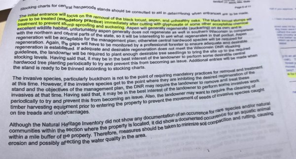

    That is a good question. I just read her contract she signed in 2012 with the DNR. The goal of her wood lot is Oak saw logs. The Black Locust is taking over. She agreed in the contract to do what the DNR recommends. The DNR guy wants the locust killed in 2018. If she doesn't do this, they could kick her out of the Managed Forest Program and she might have to pay property taxes back to 2012. Right now she pays about $1.65 per acre. Not sure what her taxes would be if she got kicked out but they would considerable more than a buck sixty five per acre,,,,,

    I just read some more of her contract. The thing is 11 pages! In the back I found a paragraph from 2012 that said she should start killing the locust then! Why the heck does this get dumped on me 6 years later is another story.
    This is the first I heard about it. I could have done a lot of Locust killing in those 6 years! They are really getting thick in that 2 acre chunk.
